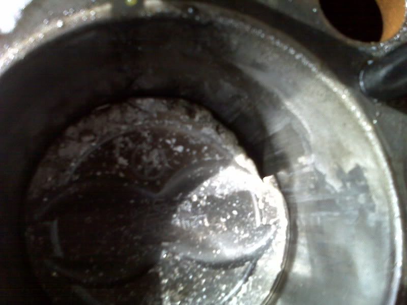

				Carnage from my 350 4 bolt

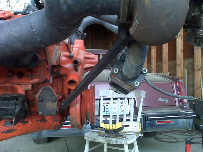

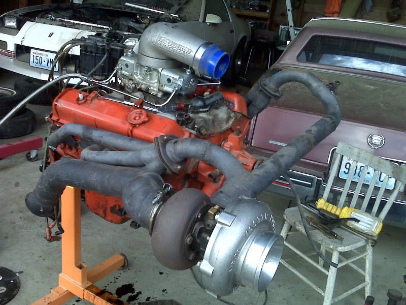

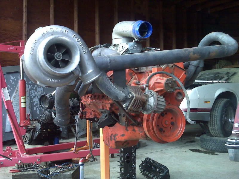

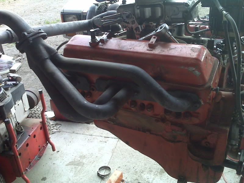

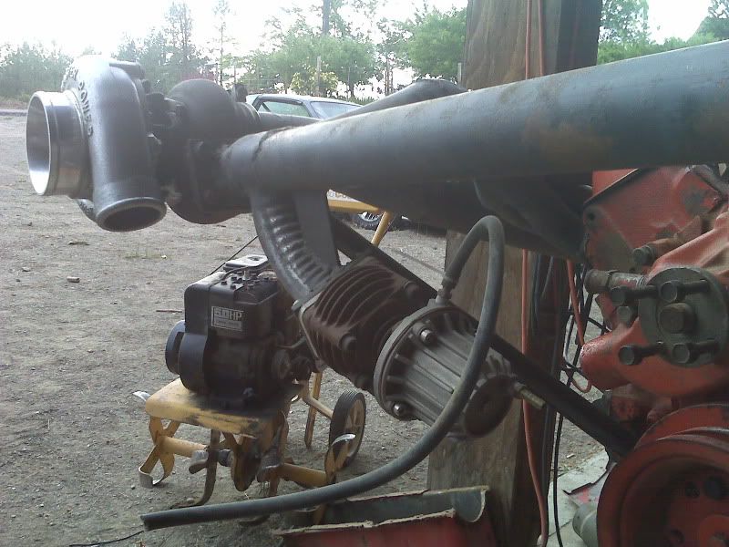

Pics of my turbo mock up.

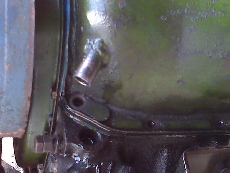

oil return from the turbo

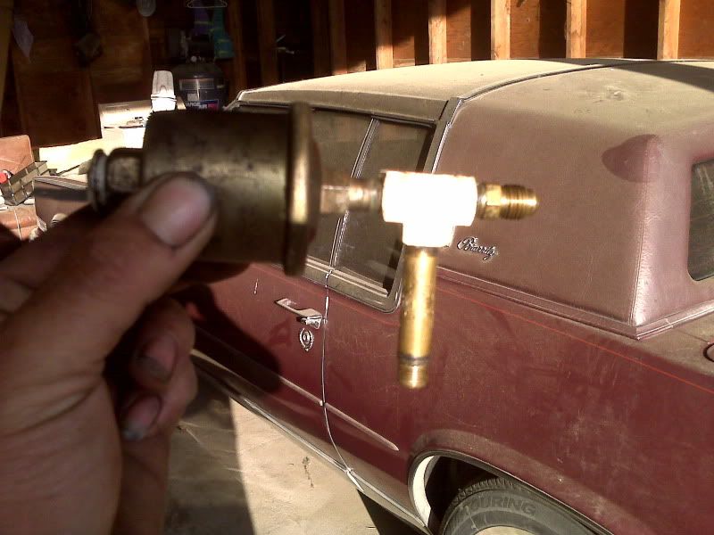

sending unit tee'd for oiling the turbo.

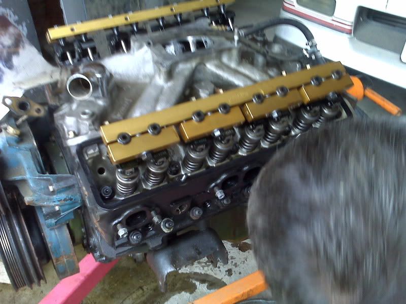

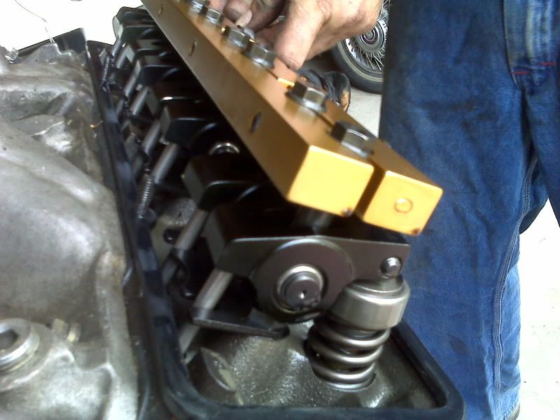

Tearing apart my valve train.

				So what have you determined was the cause of the damage?

				fuel pump lagged out on the top end.  The walbro wasn't rated for my fuel demands _________________

				yeah, looks like not only did it break the piston, but it got effing hot too.
Did you hear it knocking, or was it just one big pre-detination that took out the piston? |

				 Posted: Sun Jun 07, 2009 8:18 pm    Post subject:  |
				detonation killed just that No. 1 piston the rest are in very good shape the heads are in good shape too for the exception of molten piston splatter other wise rebuildable  the cylender wall is toasted beings it is already at .060 over its not worth my time and money to rebuild it.  but it did make a awsome firery pass and beat the other guy while doing it(12.84sec.  1/4mile).   with this poorman build i am goning to run at 7 psi of boost instead of 14 psi. _________________

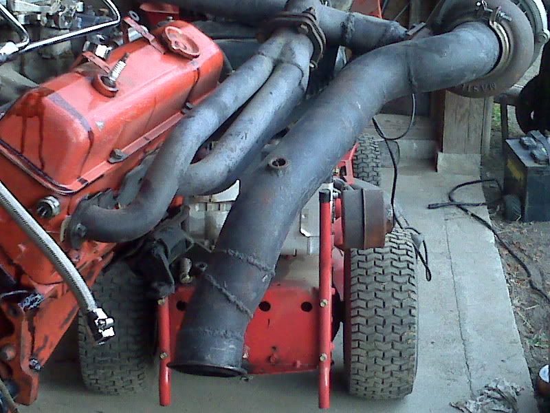

				look how ugly wide this is.

				 Posted: Mon Jun 08, 2009 7:50 am    Post subject:  |
				How does that fit?
Are you hogging all the secrets to quantum mechanics?
Just looks so big on the outside of the car... |
				 Posted: Mon Jun 08, 2009 9:04 am    Post subject:  |
				 	  | d00012 wrote: | 	 		  How does that fit?
With the battery and coolant tank relocated you actually have a surprising amount of room in front of the fenders.
BTW, any setup that badass should totally have "MASTER POWER" stamped on it.    |
