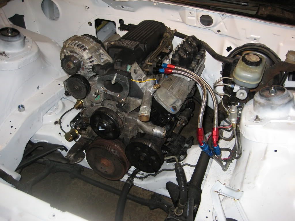

Intake going together for (hopefully) the last time:

On the fuel rail front I did exactly what I mentioned in the thread: dropped each "leg" into the vise horizontally, torched it and compressed it flat. Then I set each one in the vise vertically at the correct height, reheated, and peened into an 'L' shape again. The issue came when I needed to slot the holes in the brackets. Not having a small die grinder here (and being the impatient asshole that I am) I did it with the drill. They came out functional but not real pretty. Rolling Eyes Pressurized the fuel system again and no leaks. There is virtually no vertical movement in the injectors anymore (I dropped it about a 1/4", like I said, impatient asshole Razz).
After some forking around with that, this is the state of things this evening:

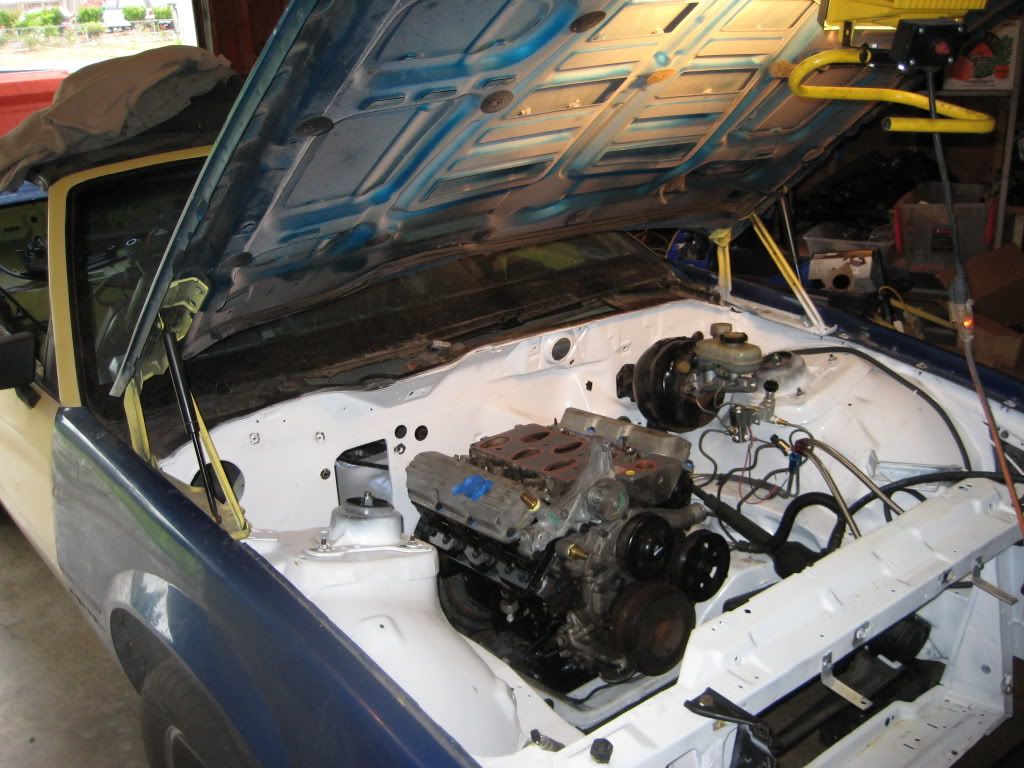

PostPosted: Fri Jun 22, 2012 9:57 pm    Post subject: Reply with quote
Look at all that room!

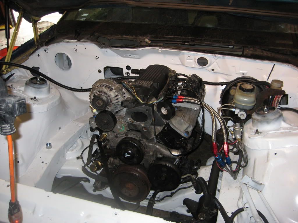

Gabe and I did indeed start it a couple times Sunday. We did not keep it running for long as the exhaust ports on the heads are wide open.
I did not get any video as I was busy jumping the starter solenoid and ECM power wires while Gabe manned the laptop hooked to the ECM, but I did snap this pic of our temporary wiring rig (there is no chassis harness in the car yet):
The CTS pigtail needs to be replaced (occasionally it wacks out but can be fixed by wiggling it) and one of the heater hose connections is leaking, but the crazy C3 coilpack and everything else seems to work well.
