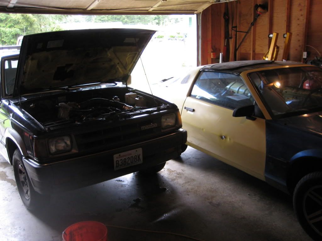

For those of you who aren't cool kids and didn't make it down to dyno let me fill you in: I have gone even more insane than I was previously and bought a mini truck the night before dyno. Unfortunately I decided it wasn't worth putting on the rollers which I regret in hindsight as it would have been cool to see the change in the torque curve with the FI.

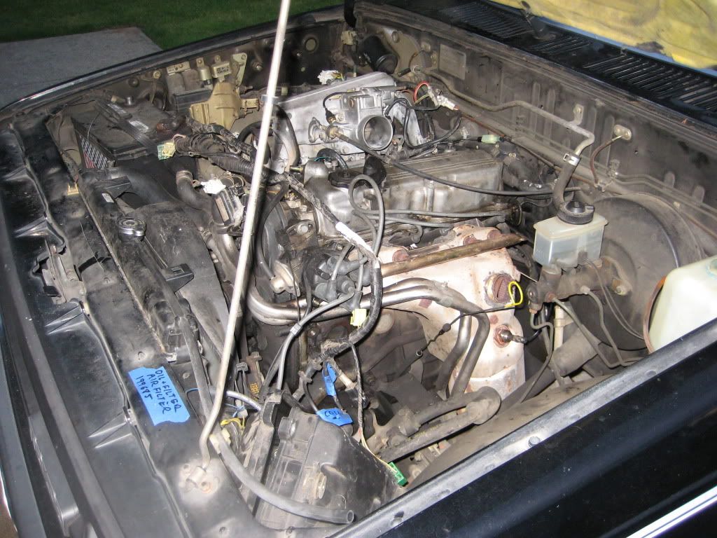

I did find the one thing I hate more than automatic transmissions, and that is Japanese carburetors. This truck has the god-awful Nikki 2bbl feedback carb on it. The issue with these carbs is that the EGR and mix control solenoids are known to get sluggish or downright stuck and cause everything to run like crap.
The truck had no power below 3K and would outright stall if you didn't floor it when it was cold, so obviously it was running lean below a certain point. I was down to about 23mpg from all the driving with my foot on the floor, and it probably wasn't too good for the rest of the motor either.
After looking at options for a carb swap (Weber 32/36 or Holley 5200) or an EFI swap using MegaSquirt or something, I found a couple guys who had built custom intake manifolds and used the EFI system from a Mazda 626.
Now the 626 EFIis a real dumb animal. It has no spark control (uses a vacuum distributor) no IAT, and no crank or cam sensors (uses the coil). This makes it very easy to swap. The downside is finding or building an intake. Not wanting to mess with building one I found a manifold off of a newer B2200i and had it shipped up here.
I then went to the local Mazda junkyard (the one off Canyon Rd. for those who have been to my house) and bought the entire ECM, harness, injectors, ect. off an '89 626. That was my first mistake. The few people who had done the swap had used '90-'92 cars. I asked Jeff (who owns the Mazda yard) if there was a change for the '88-'89 and after some fumbling in the manual he said there were "no significant differences" which I later found out meant "there are no significant similarities but I don't have a '90-'92 and I want your money."

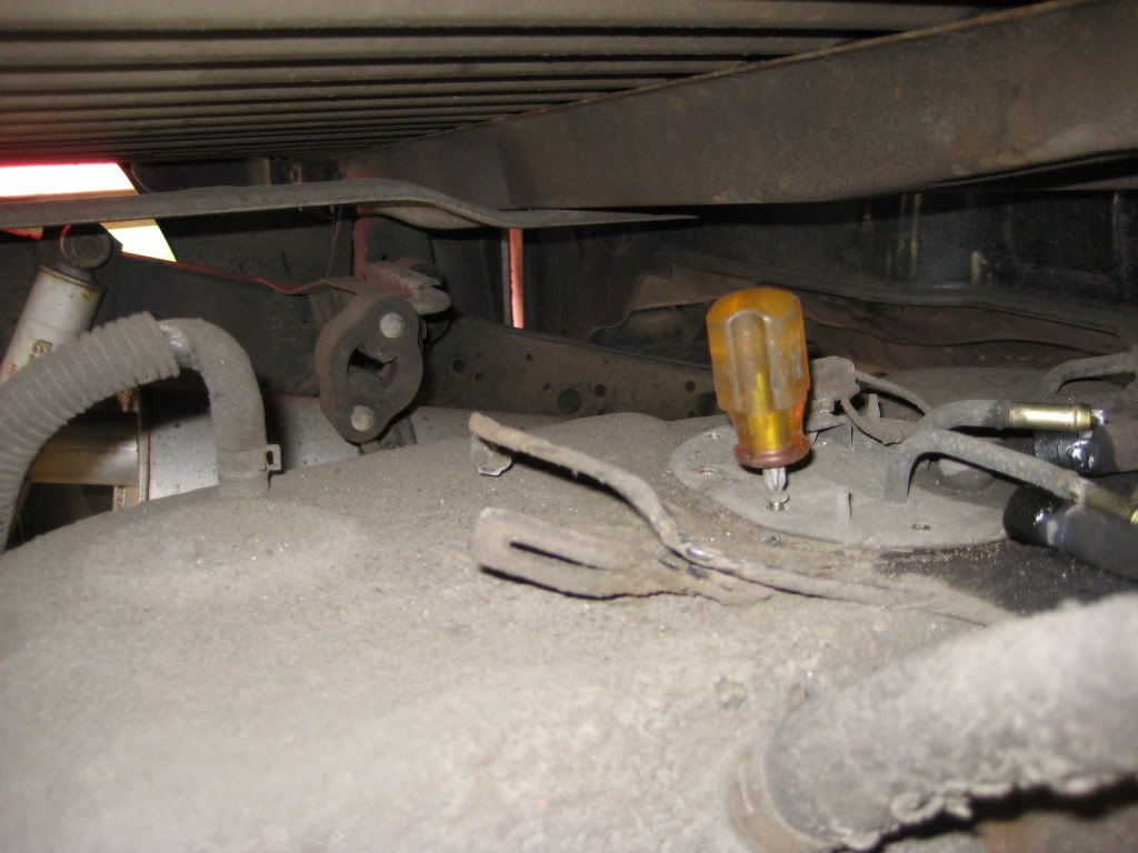

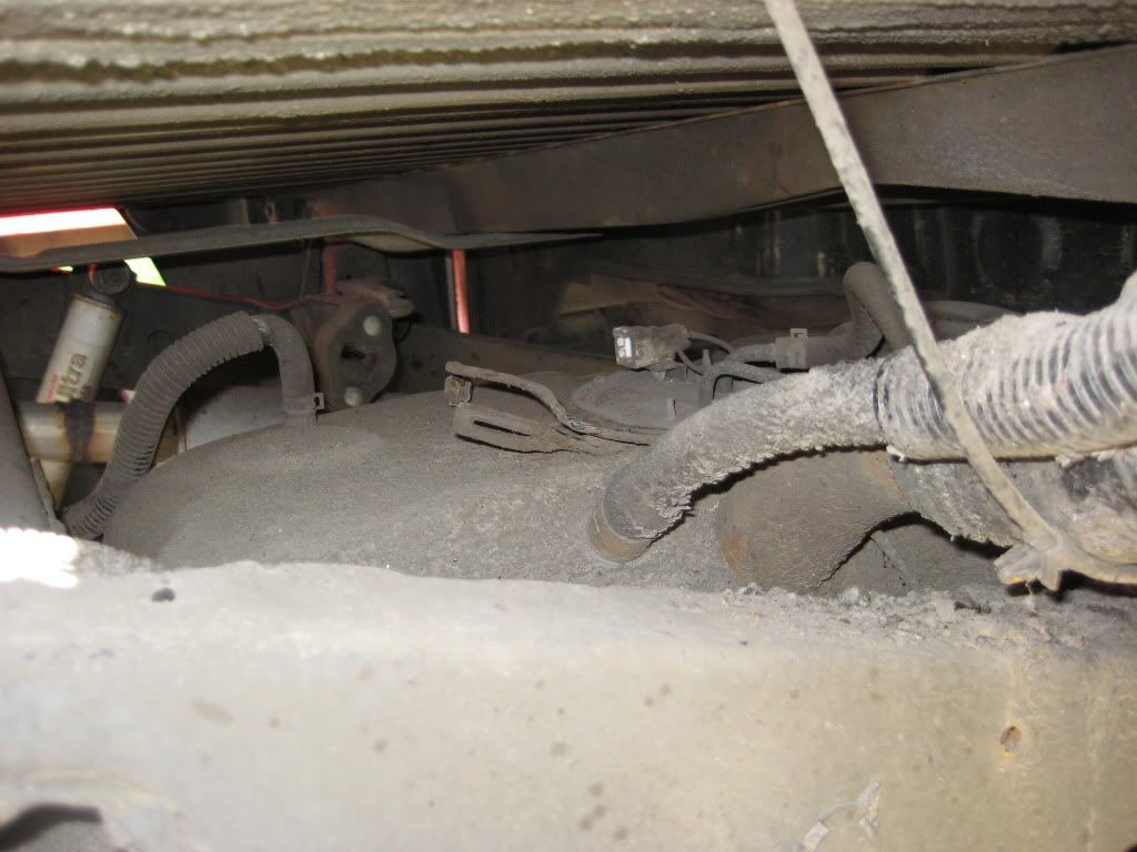

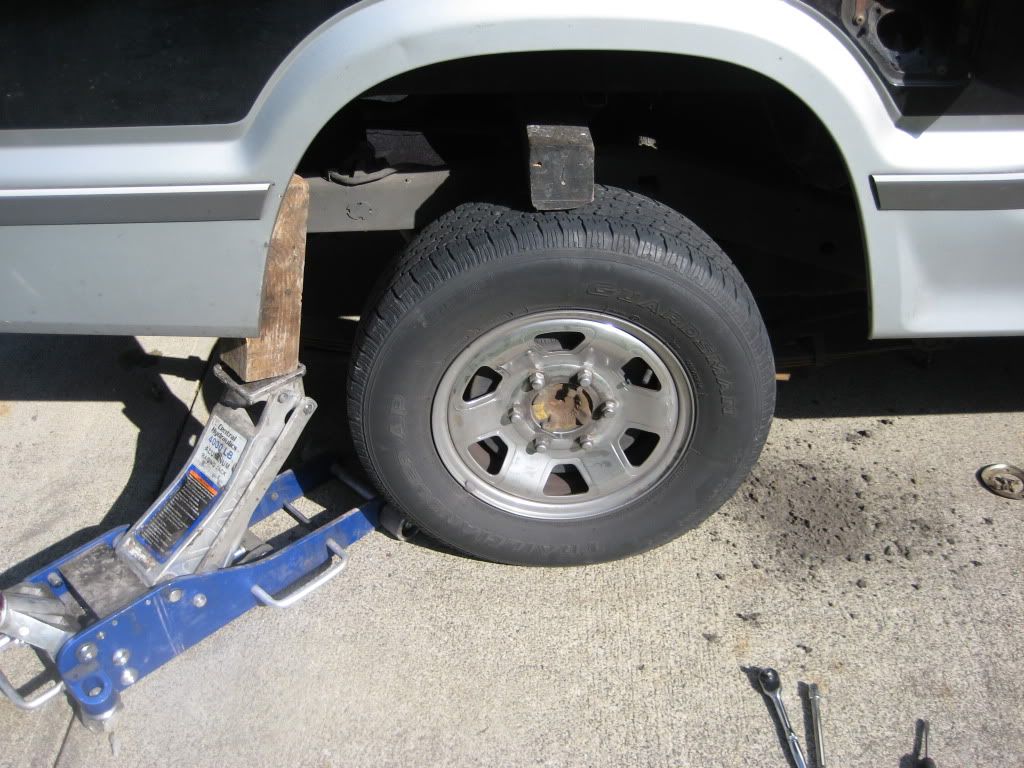

Saturday I started with the fuel pump. There were about 7 gallons of fuel in the tank so I decided to lift the bed rather than drop the tank. The horizontal 4x4 is only there so my face isn't the widest thing between the frame and the bed
There's the culprit right there:
Mazda eschewed the traditional ring setup for a silly lock plate and philips screws. I replaced the screws with proper hex bolts due to my annoyance removing these:

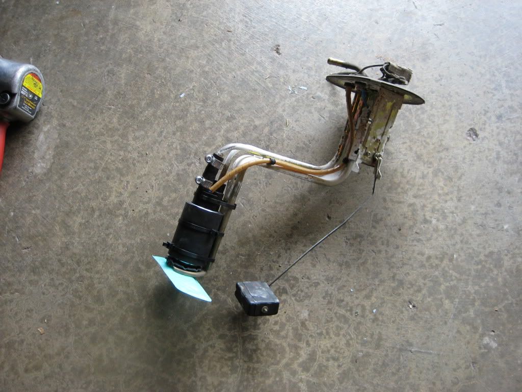

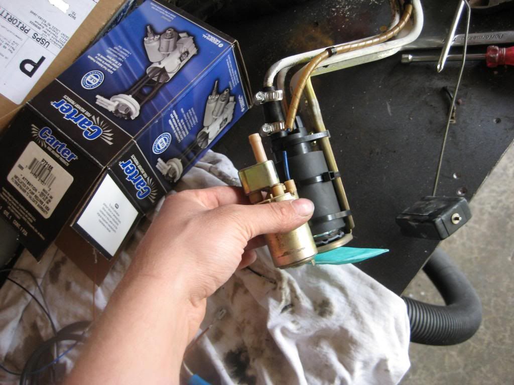

I didn't get any pics of it but the Mazda uses a low-pressure electric pump for the carb. It is small and useless and mine had no sock on it which may have been a big part of the lean issues, but whatever.
All EFI imports from that time period used basically the same pump. The Carter pump I bought had hundreds of applications listed in the catalog. The upper clamp was too low so I zip-tied it all together. This is the new pump in the old (carbed) pickup:
You can see the size vs. the old pump:

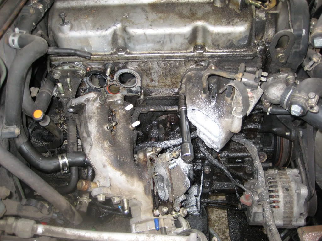

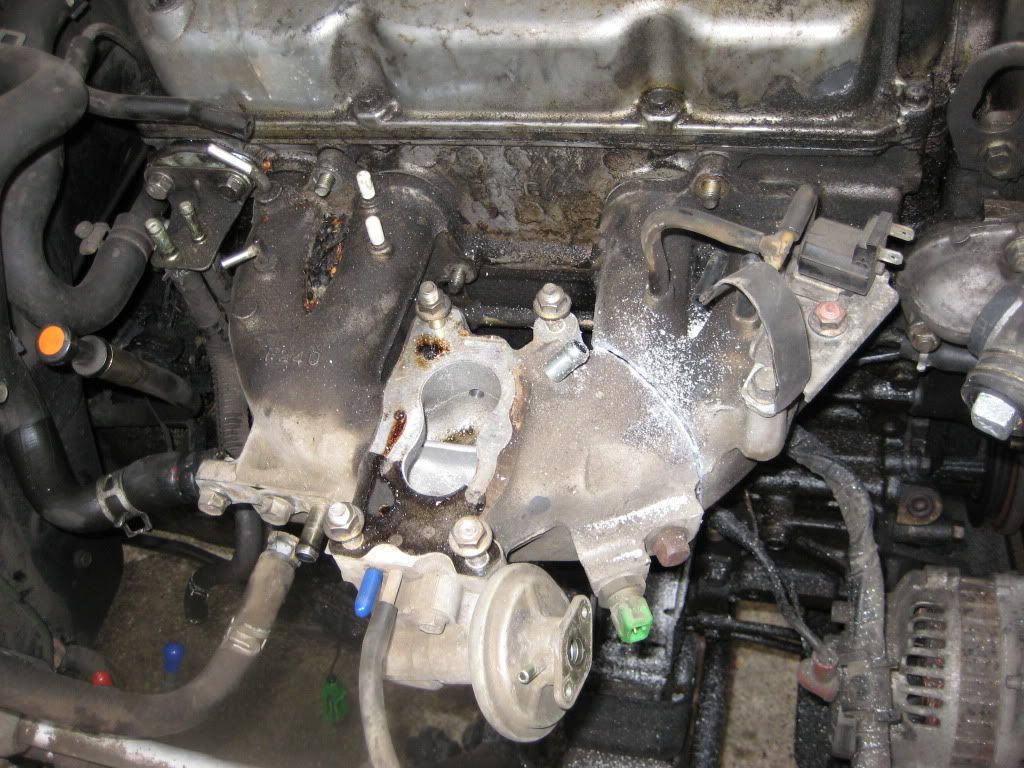

Carb removal was fairly uneventful until a nut froze on one of the studs and rounded off. Figuring that no one in their right mind would want to buy a Mazda intake manifold (and considering what scrap aluminum is going for) I got out the Milwaukee and "fixed" it:
Yup, fixed it good. I'm subtle like that.

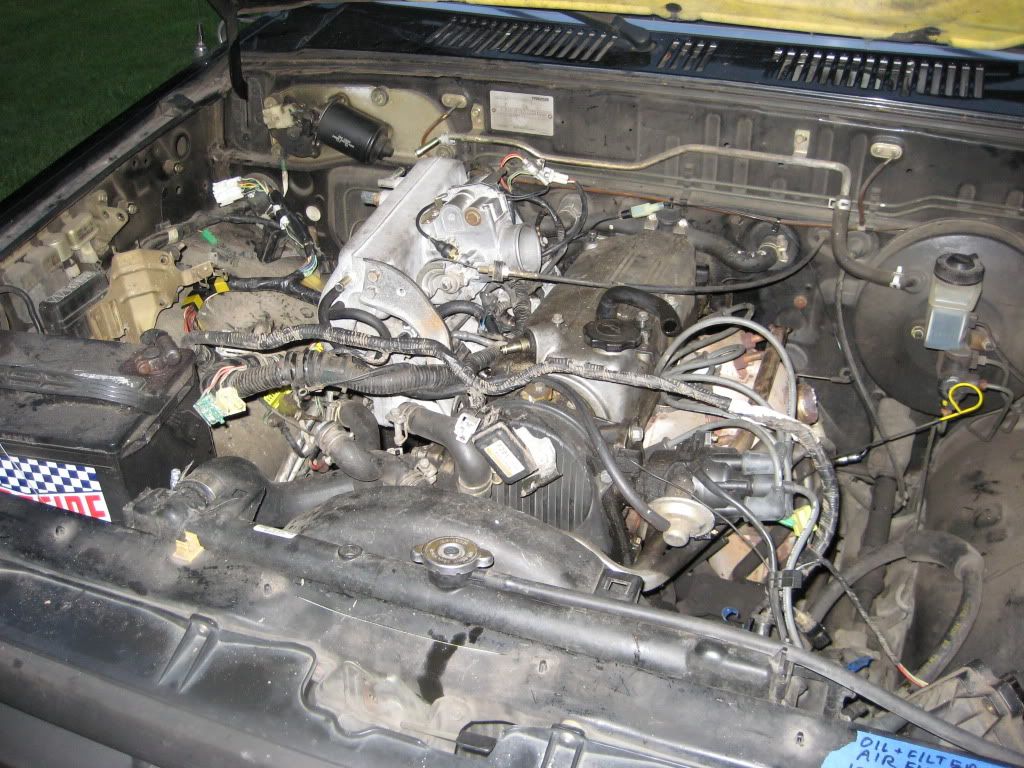

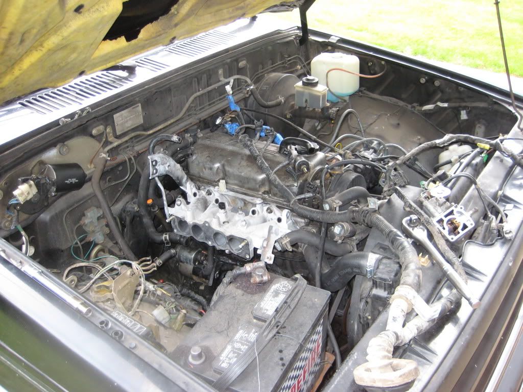

LIM goes on:

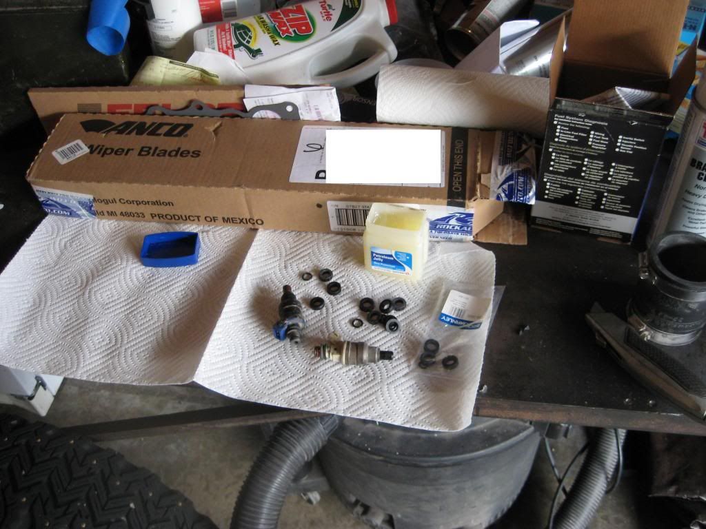

Injector prep (Vaseline FTW!):

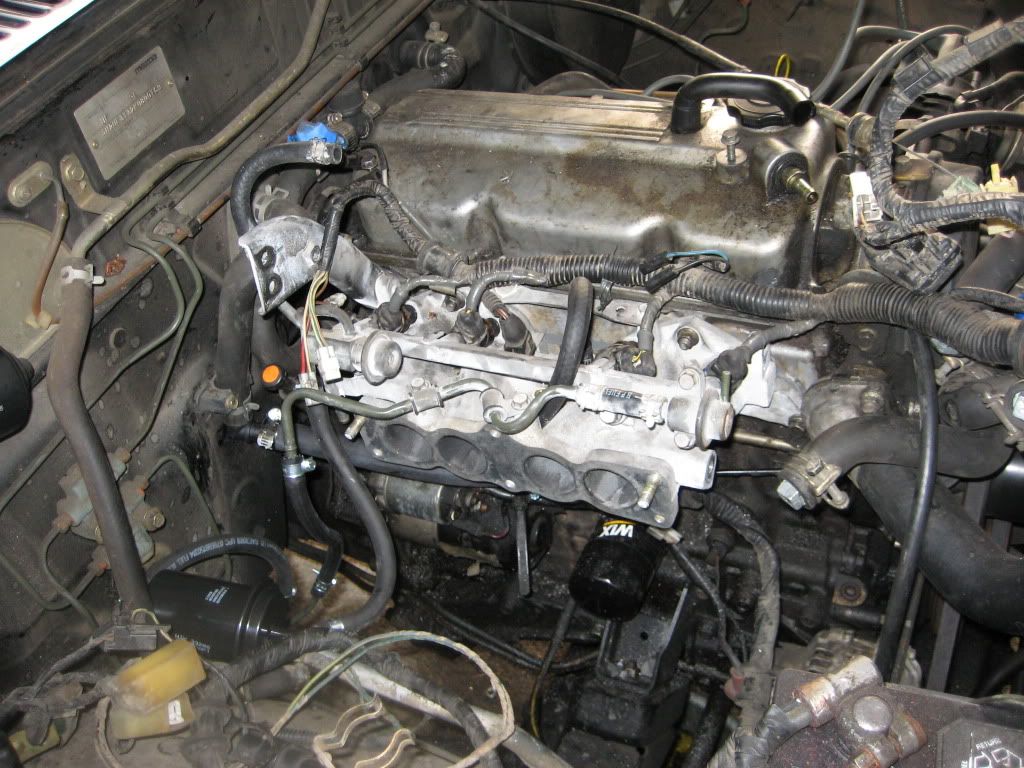

Rail on and harness routed:
UIM on and airbox mocked up:

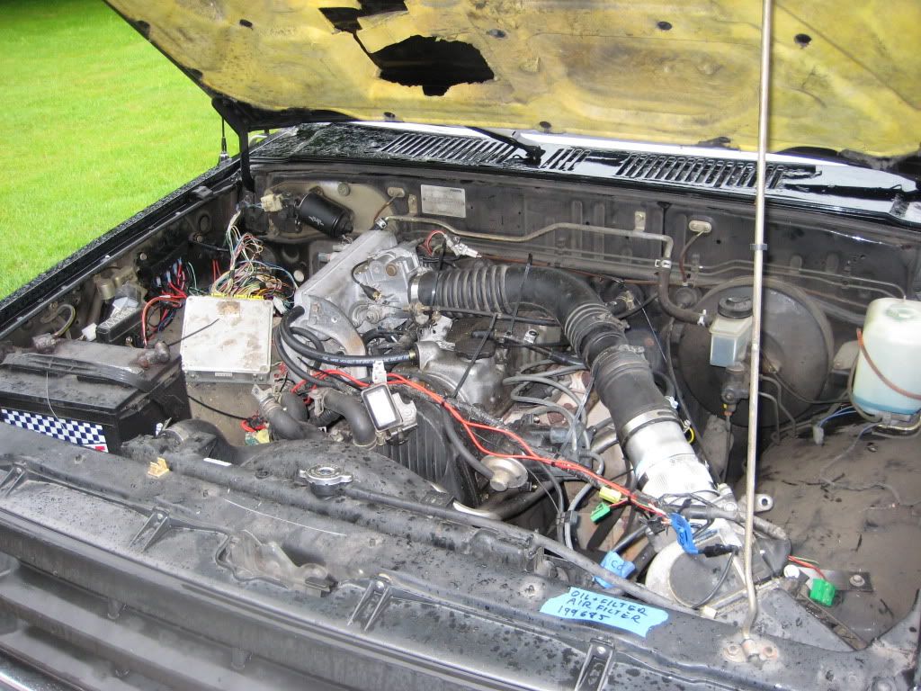

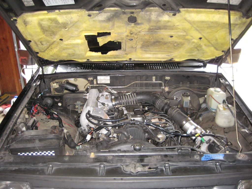

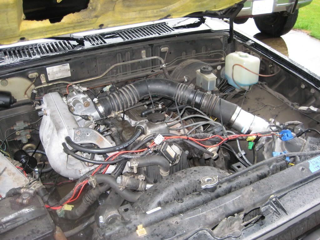

Today I finished up the intake piping, made up of the intake from a 1986 Isuzu Impulse (yeah! ) an exhaust adapter and a no-hub sewer pipe connector. Then I went brodying around in the rain. Throttle response is a night-and-day improvement. Top-end power seems about the same but that's to be expected on a 25-year-old Japanese four-banger with 200K on it.
I still need to re-wrap the harness, figure out where the heck to put the ECM, and finish a lot of little stuff.

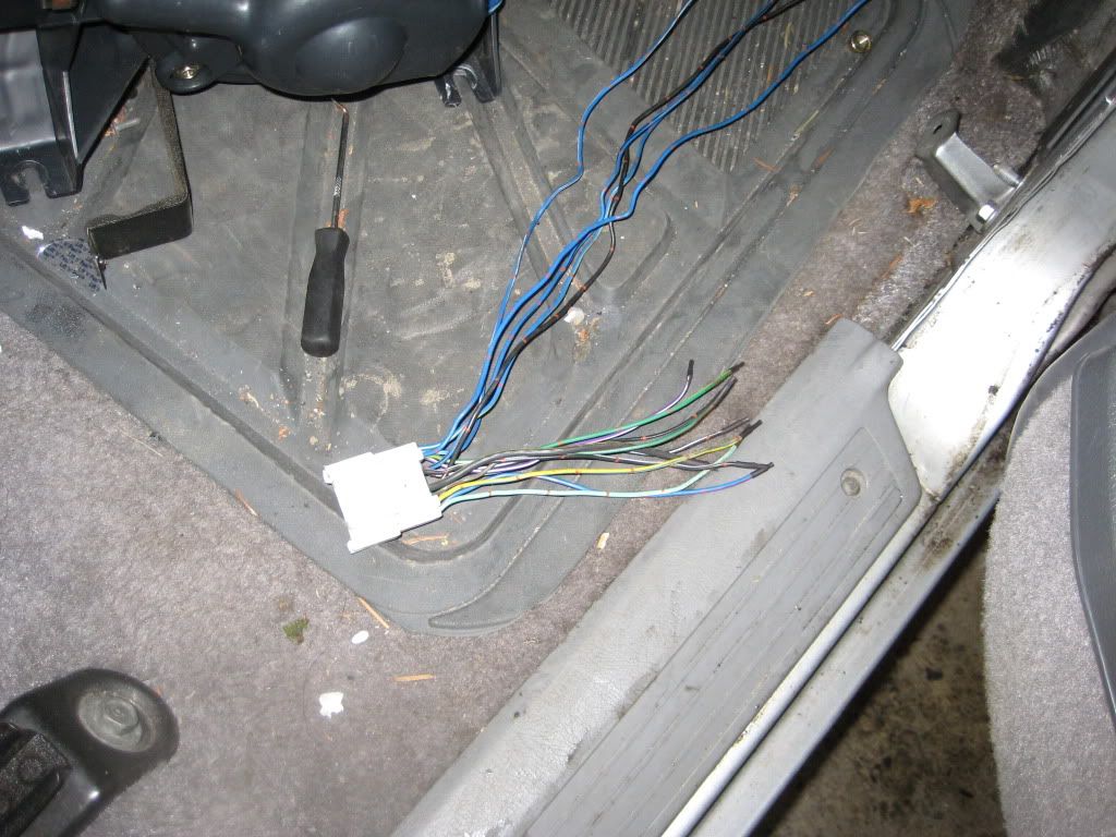

Mazda ran the wiper motor wiring through the truck's ECM harness because of course the f***ing did. The blue wires all go to the wipers, the rest were cut and capped with heatshrink:

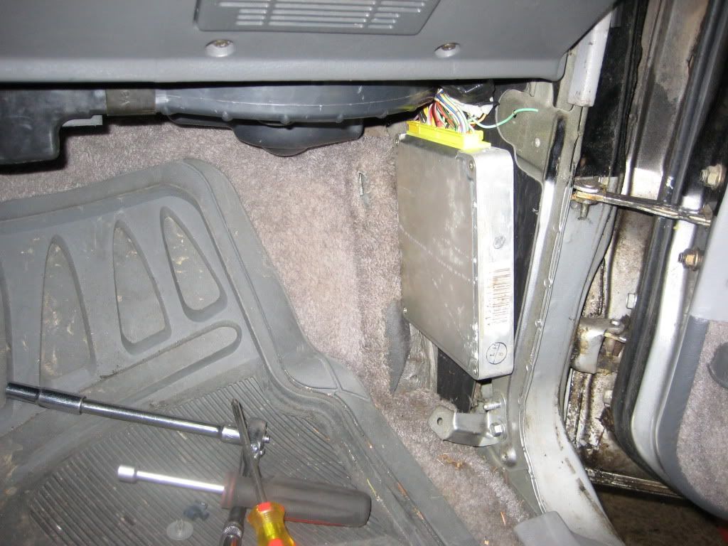

The ECM's are dimensionally identical but the new one had very different brackets. The brackets on the old unit were welded on and didn't look super reusable so I just laid it in there. The kick panel will hold it. Surprisingly enough the wiring harness is the perfect length.
All wrapped up. Harness retaped, crankcase vent tube mounted properly in the snorkel, overflow bottle mounted up out of the way.
