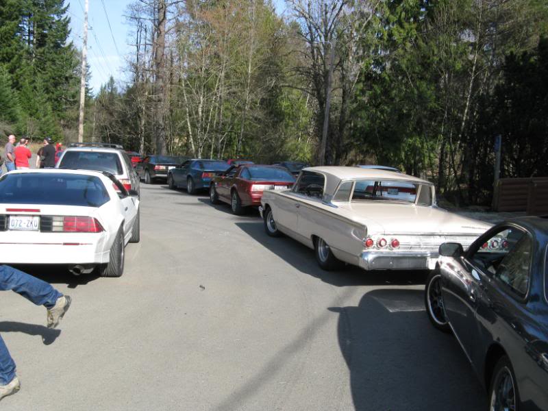

Jon, did you buy these as bolt-on spindles from Paul, or did you just buy the brake components?
Notice the front tire of Paul's car in this shot:
PostPosted: Tue Aug 16, 2011 8:05 pm    Post subject: Reply with quote
QwkTrip wrote:
I doubt it. Twilightoptics had this on his car and he's a very competent mechanic. If the bearing didn't fit he would have noticed for sure.
Agreed. I forgot you got them from Paul.

Spindle and all. Just mounted it to my struts and A-arms. I did install new rotors from SSBC. They are same depth as the original rotor that came with Paul's setup.
I'm a bit perplexed at the moment. I guess I'll be doing a lot of measuring this weekend.
