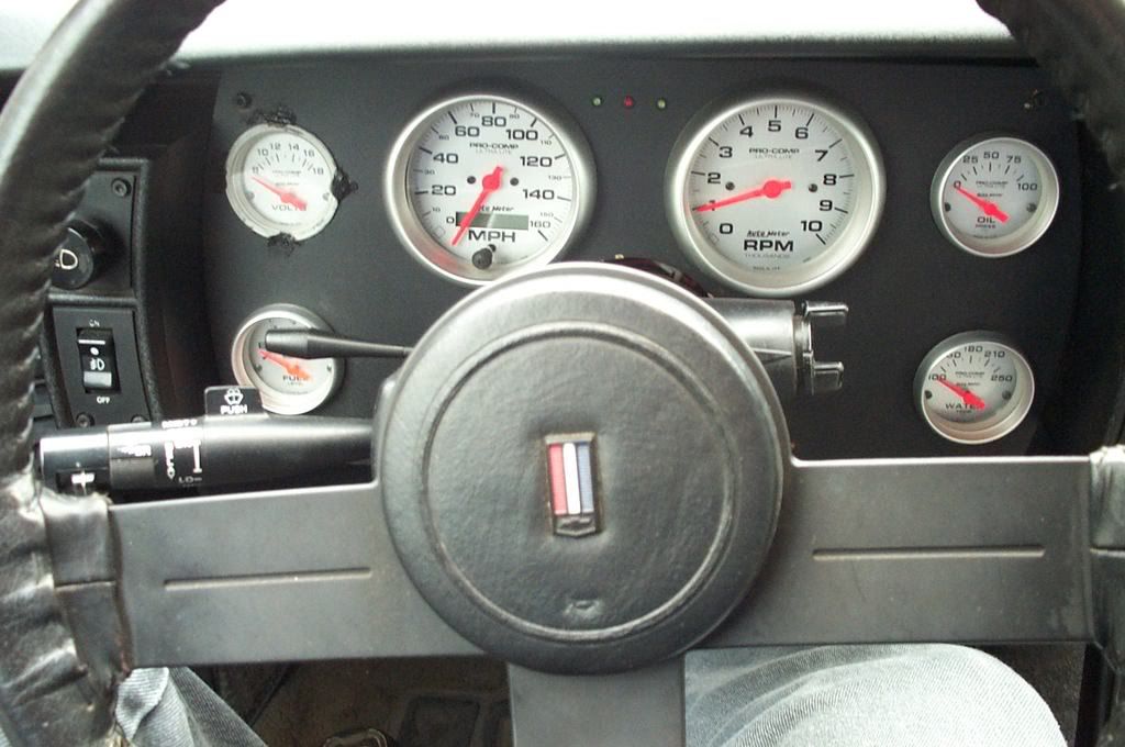

Before I sold the IROC I was planning on a 90-92 dash swap for it. There is basically the same amount of usable room in those dashes as there are in the older ones.
This is of course assuming that you have a totally new plate and all new gauges, and don't patch the new tach into the stock dash (like Travis' LT1 car).
*Edit: Found a pic I pulled from TGO way back when I hatched this scheme, and a pic of my old setup for reference. (And yes, I am aware that I single-handedly ruined this topic )
