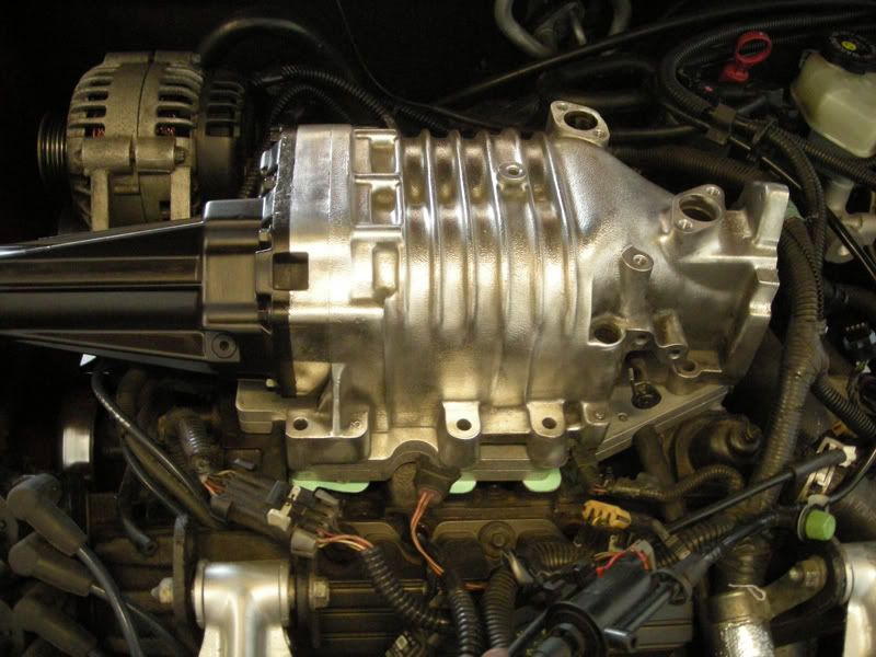

Blower on...

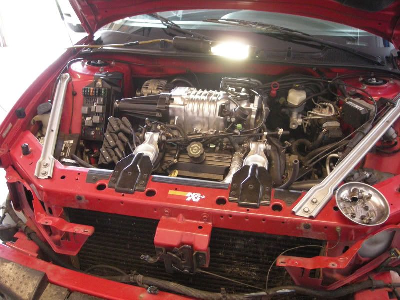

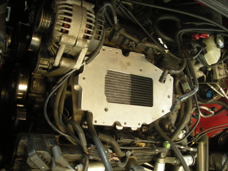

Blower off, core in place...

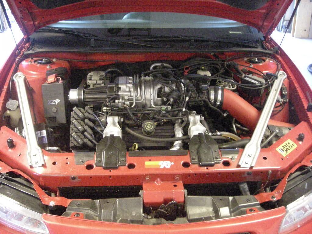

Blower on, sandwiching the I/C Core between the LIM and the blower.
All back together...then...

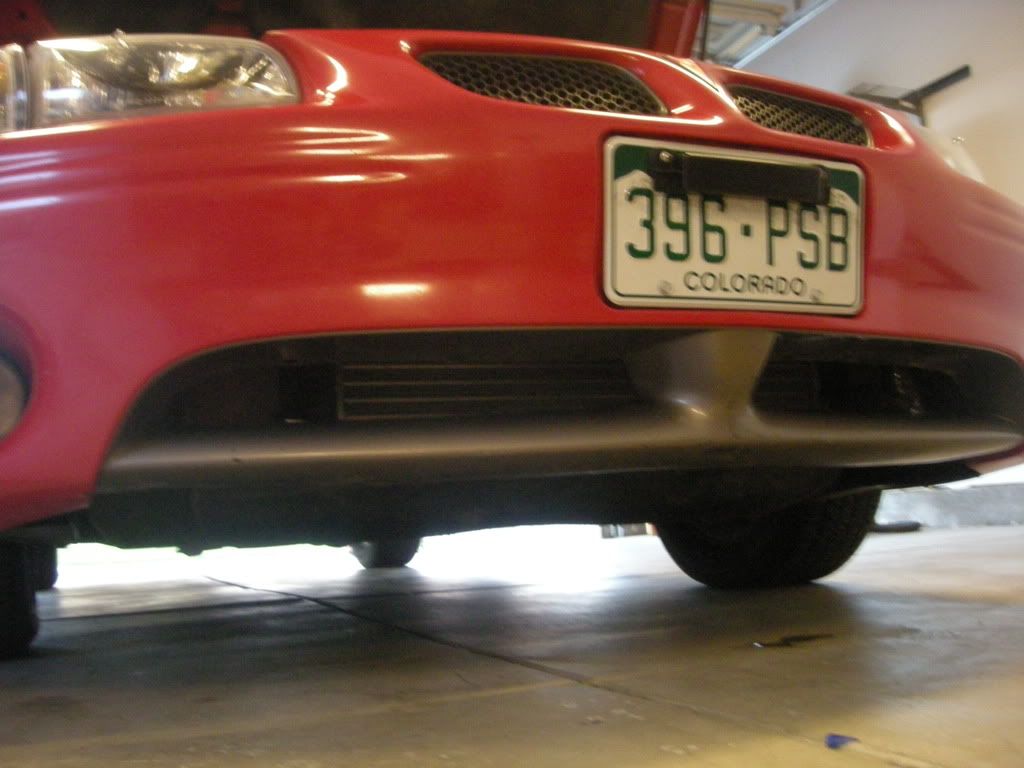

...to the heat exchanger. But this one didn't cut it so...
Got a MUCH larger heat exchanger to extract more heat.

Oh, it's mainly to kill knock, but a knock free setup could see up to a 50 WHP gain!

So it's an air/water intercooler? How does it pump the fluid through? Looks cool. The new vette has a similar setup.
Yup, there's a pump that pumps the fluid through it.
