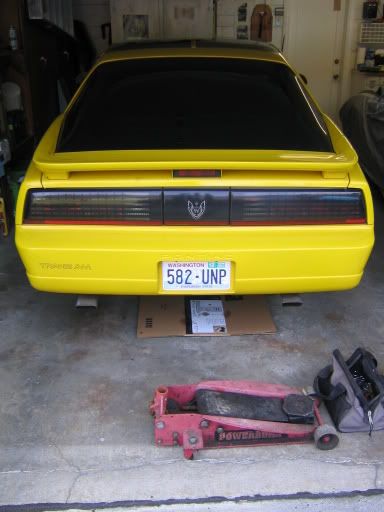

A certain yellow bird perched atop its jackstands.

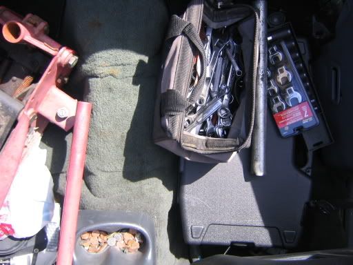

Grabbed as many tools as I could stuff in the bird.

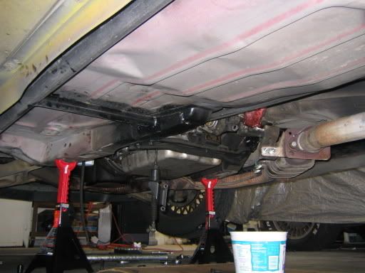

It really doesn't look like we did much. Those bellhousing bolts were hard to get to...
Well we left the trans in, got it all ready to yank out. But I forgot my extra flexplate at home like a dumbass. So anyone have an extra t56 laying around? Most all of the bellhousing>engine bolts were loose. Didn't take much effort to spin then, most of the effort expended was just reaching them.
