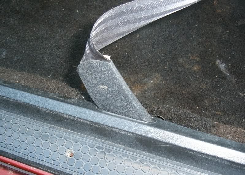

When you get ready to put those 4th gen belts in let me know. I just finished my 4th gen belt changover. I can't tell you how much nicer they work than my old ones. To me this rates right up there with SFC's as an upgrade.

Yes, a major improvement. My stock belts kept catching and took several tries to get them extended so I could hook them up. Then sometimes they wouldn't retract back and tighten up. I kept buying new (used) belts and all of them failed after a short time. With two retractors there are a lot of moving parts to wear out. With the 4th gen belts there is only one top retractor and it works so much better. Not to mention the 4th gen belts are still available new.
But when you do change over to the 4th gen belts, if you have a 83 or newer car, there will be a huge hole in the sill plate where the bottom retractor was. This is solved by using the 82 style sill plates. Pic is of the 4th gen belt and 82 sill plates, and below that a comparision of the different style sill plates.

Hey alloy, when you do the 4th-gen belt swap, do you need to keep the belt clips on the other sides of the seats, or do you reuse the old ones? Is it even possible to install the later belt clips?
Mine are the recalled kind, and they haven't given me any trouble yet, but I figured I'd fix them while I was messing around with the belts anyway.

PostPosted: Sun Apr 29, 2007 4:35 pm    Post subject: Reply with quote
You use the 4th gen belt and the buckle end also. The new belts won't fit in our old buckles.
