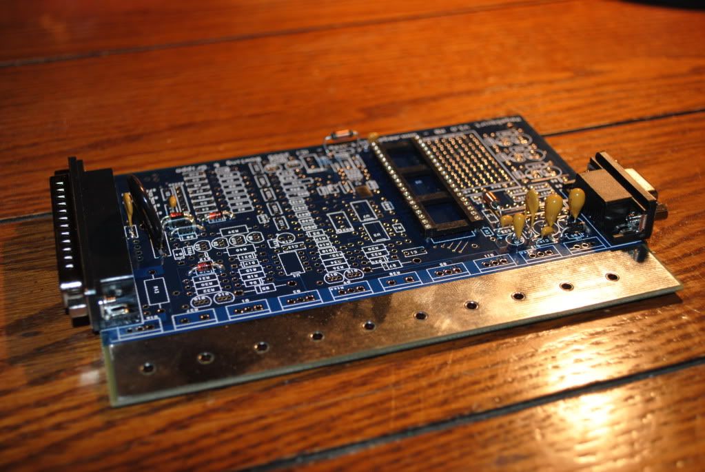

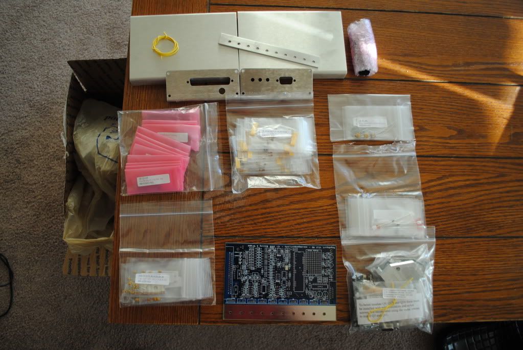

The MS kit comes as a big assortment of electronic components. As seen here:
So, I worked on it for an hour or so and built most of the power distribution circuit and attached the DB9 and DB37 connectors.

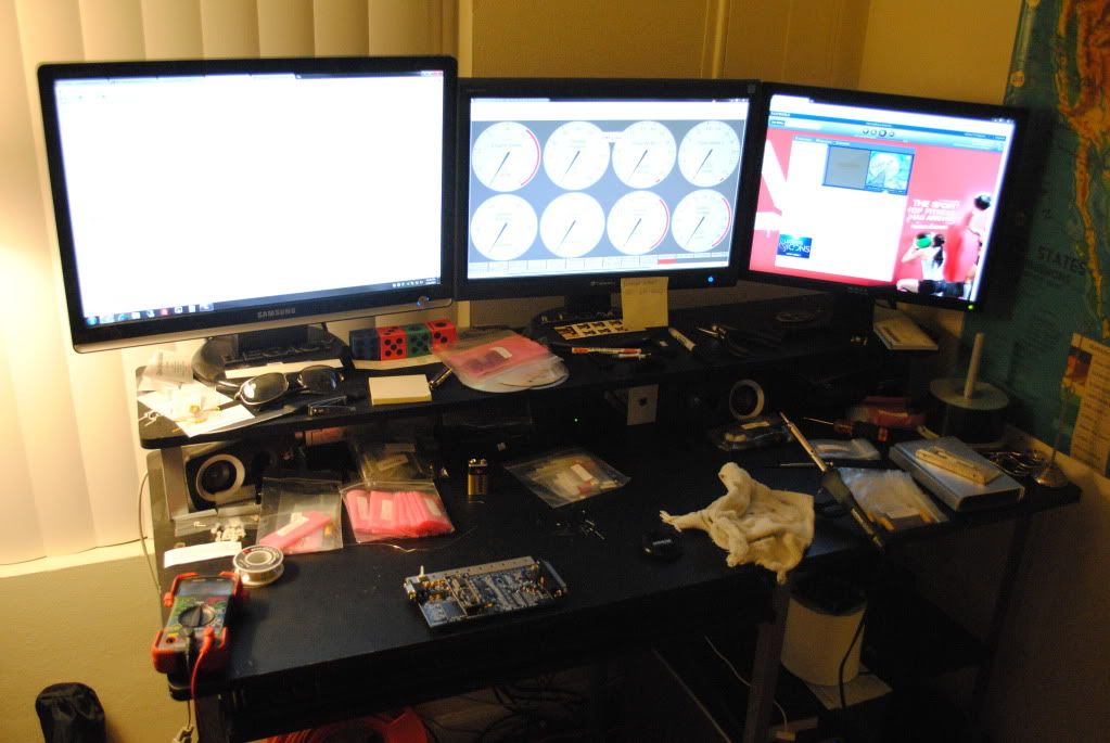

Here is my workspace. It's a little cramped, but it gets the job done.

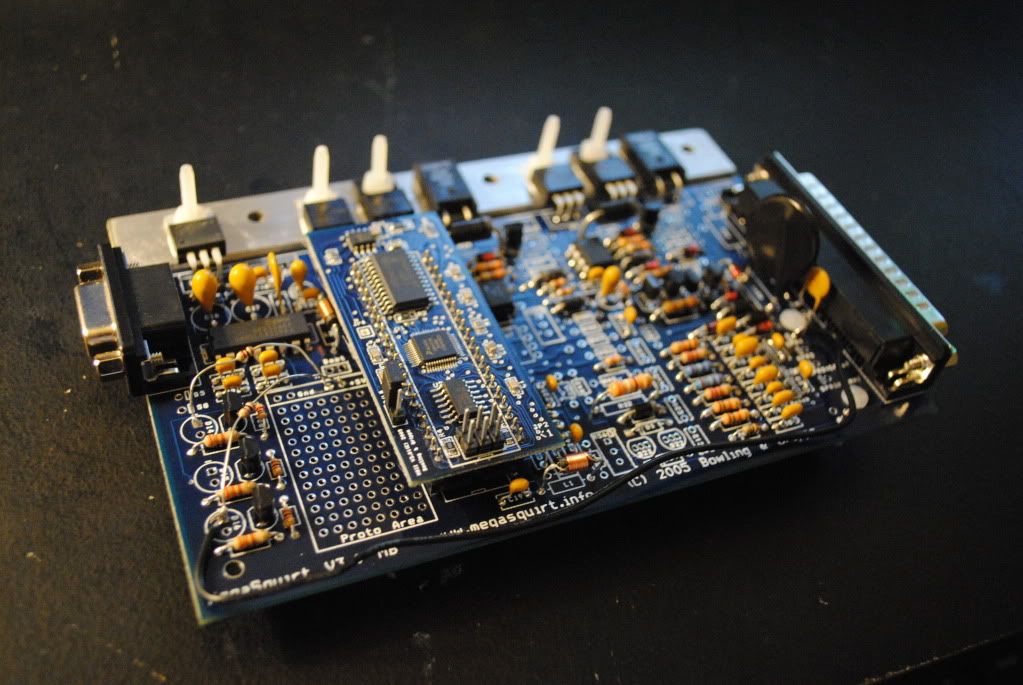

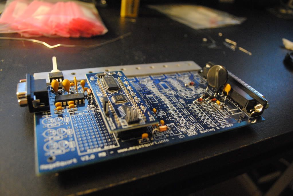

Here's how the board is looking now:

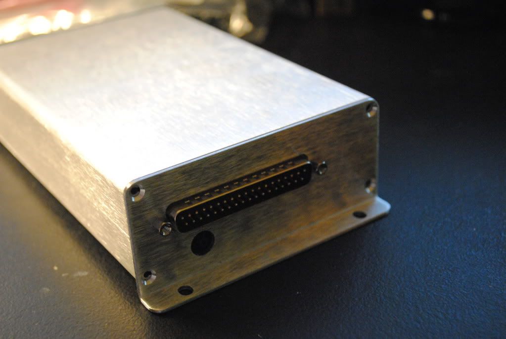

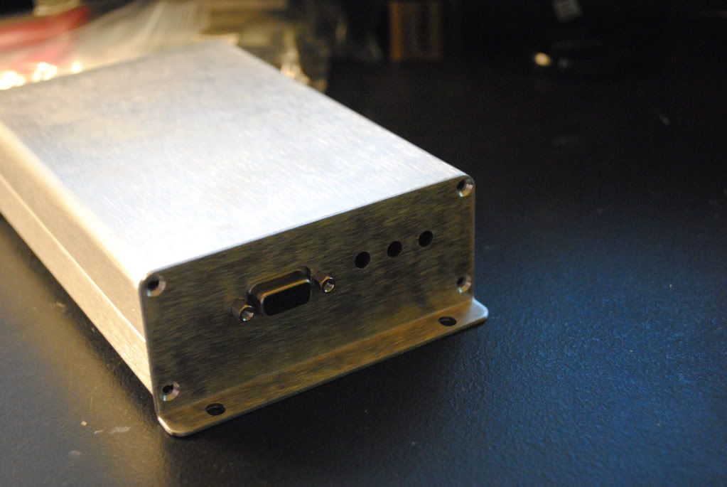

Board placed in the case, DB9 connector for the tuning cable.
Other side, DB37 for engine control and the hole hides a little MAP sensor behind it for Speed Density.
So here's the board. Pretty cool, eh?

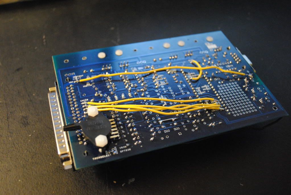

Here's the bottom of the board, with some miscellaneous ignition jumpers and IAC jumpers. The black thing in the foreground attached to the bottom of the board is the MAP sensor.

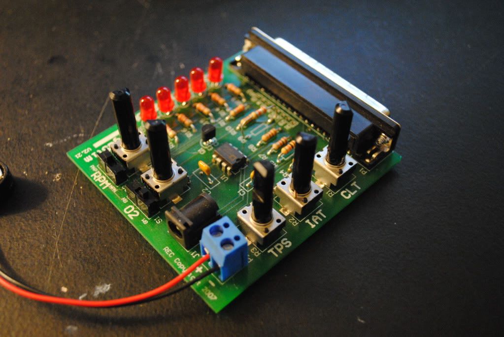

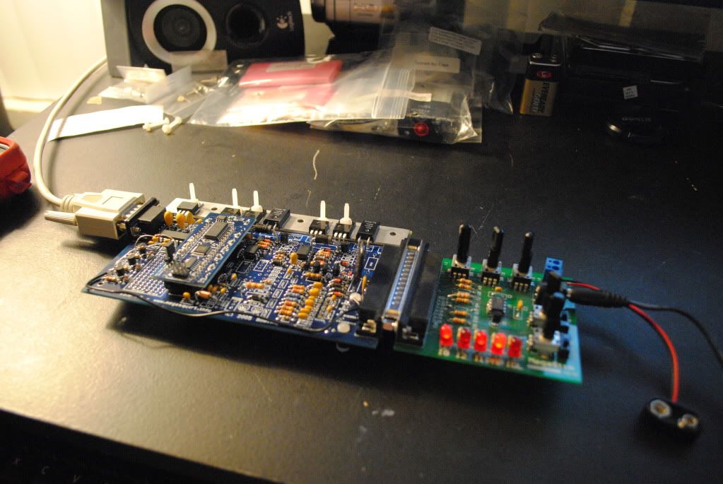

So to test this thing without the car, I have what's called a "Stimulator" or MegaStim. It simulates several engine sensors and has LEDs for several of the output functions of the MegaSquirt. I have it plugged in and running in this picture. You can see the LEDs are lit. The LEDs show, in order:
(Spark Events)(Injector Bank 2)(Injector Bank 1)(Fuel Pump Relay)(Fan Relay)
Here's a better picture of the MegaStim. I built this board when I first MegaSquirted my Z28 a couple years ago.

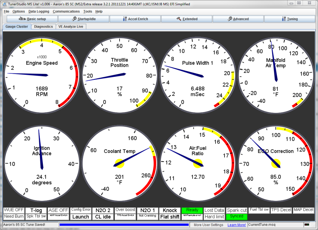

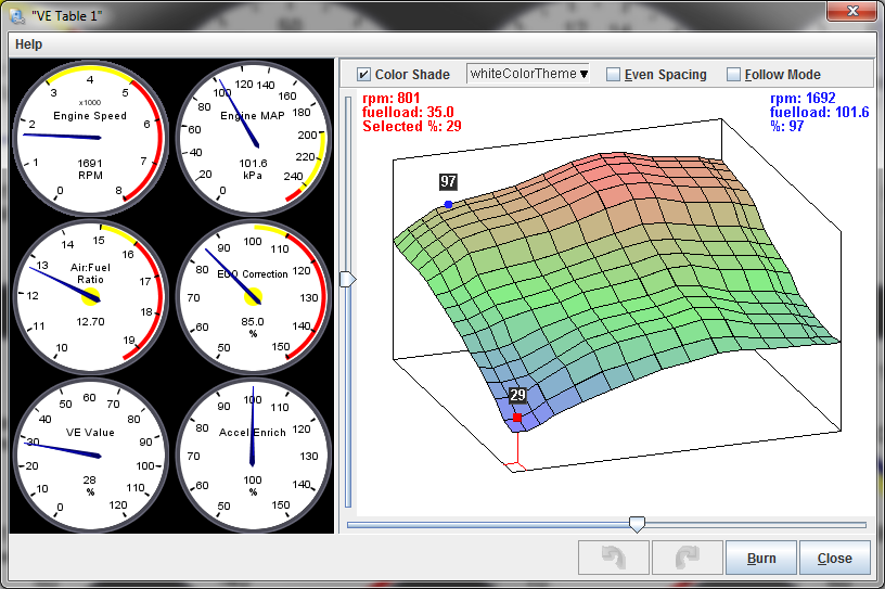

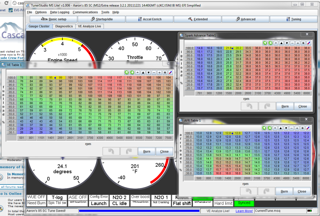

So, on my PC I am running TunerStudio MS, which is MegaSquirt's preferred tuning software. I have a couple screenshots of it working and connected to the MegaStim for inputs and outputs. This is the dashboard view, and the squares across the bottom are indicators that can light red or green depending on state of the associated function. The gauges are pretty much self explanatory.
This shot shows the three main tables you are worried about. The Spark Advance Table, VE Table, and AFR Target Table. Default values in these, which might be good enough to fire Aaron's motor up and idle. Not well, though.
And here is the actual tuning view of the VE table. You can change values in the previous table as well, but it's nice to see the smoothness and the curve of the table in this view.
