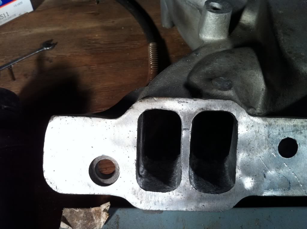

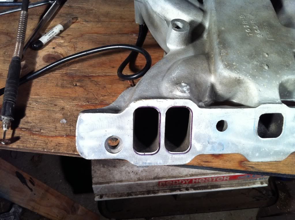

So I bought a different intake for my pontiac off of ebay awhile ago. Turned out to be cracked, got some of my money back and had it repaired. It's a holley street dominator. Supposedly my stock cast iron intake actually flows better then this single plane.. I dont really see how since its basically wide open. I mean you can actually see clear through to a port on the other side! So I'm doing some port matching and some clean up work. At the very least it will be lighter! Laughing
Piktars.
I'm hoping this will do something anyway. And it's one of the few manifolds that will actually fit under my formula hood. It almost looks to be shorter then the stock dual plane even.

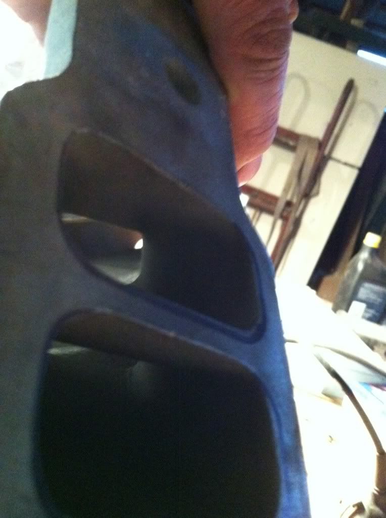

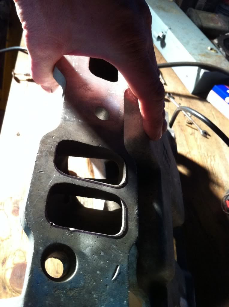

After port matching I don't see much reason to port the rest. Just ground into the port a couple inches. Man the ports were off though! And they were smaller at the flange then just inside. Almost had a lip.
