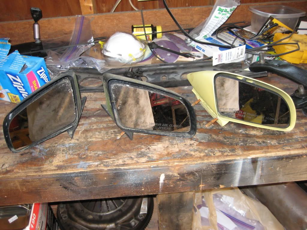

So today at the junkyard I was shocked to find these (mirror off of the Banana used for comparison):

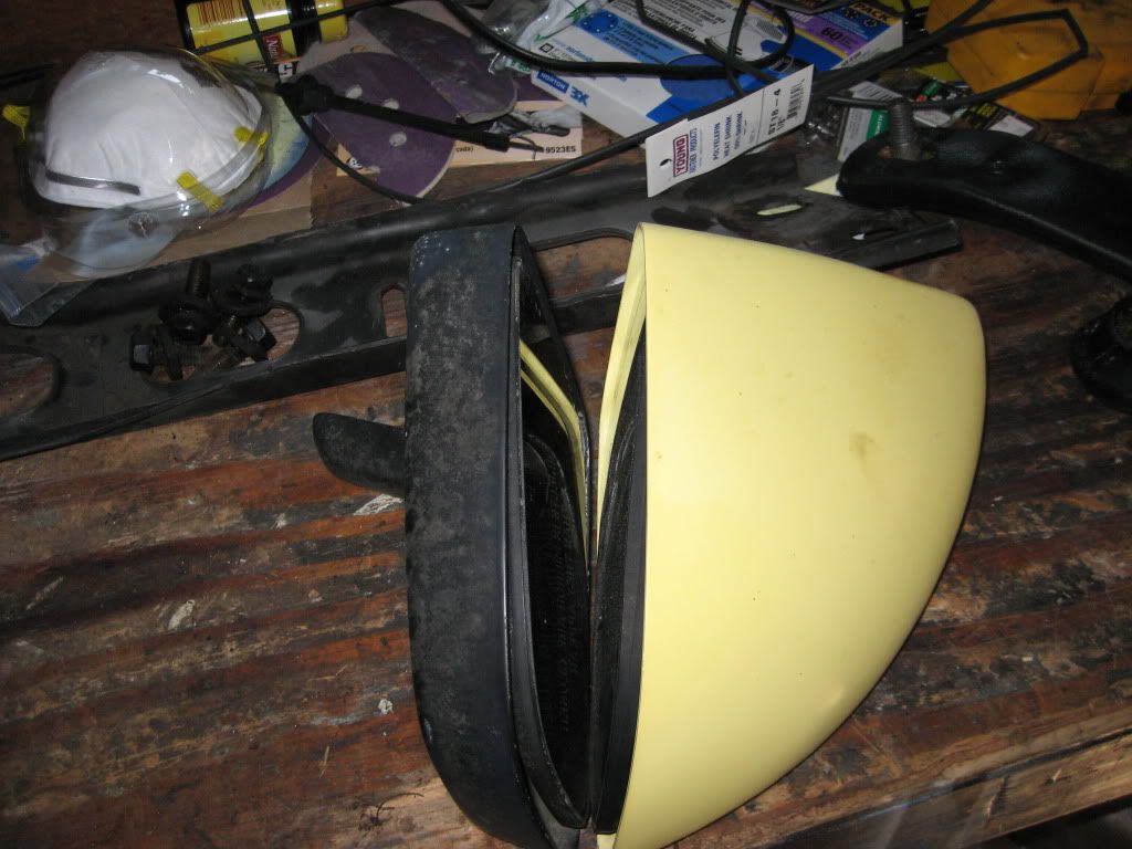

They are the same frontal dimensions as the normal mirrors, and they use the same glass, but the shell is flat on the back:

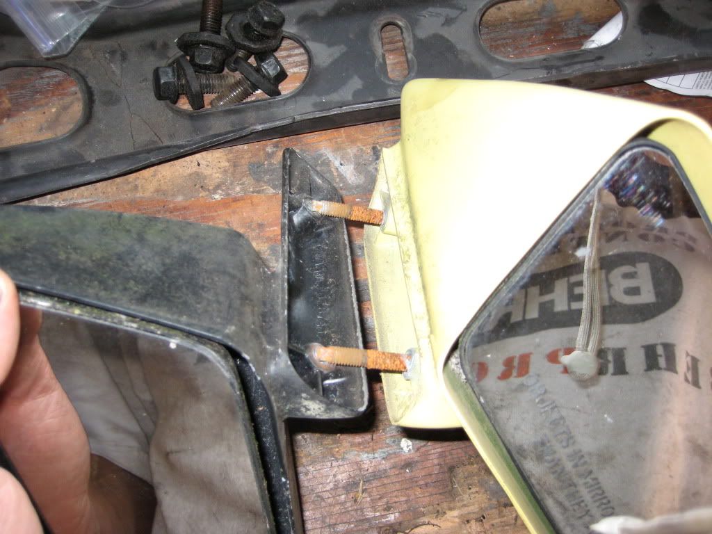

Same bolt pattern:
They have LH and RH respectively stamped on them, as well as a GM-looking part number, which is making me think that they are not aftermarket. The3y use a different plastic seal than the normal unit, but the same holes. They are bevel to fit perfectly on thirdgen doors. They are both true manual units (spring and a pivot ball inside both units).

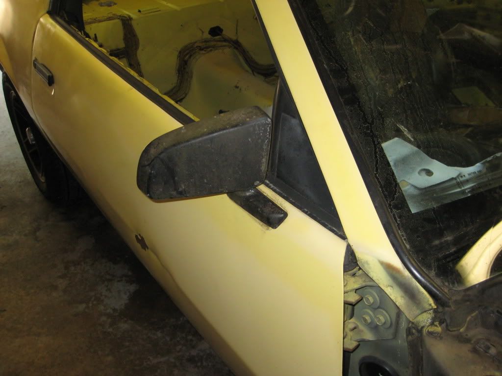

I threw one of them on for the heck of it, and I don't think they look half bad. As a cool bonus they are a bit lighter as well. Very Happy
