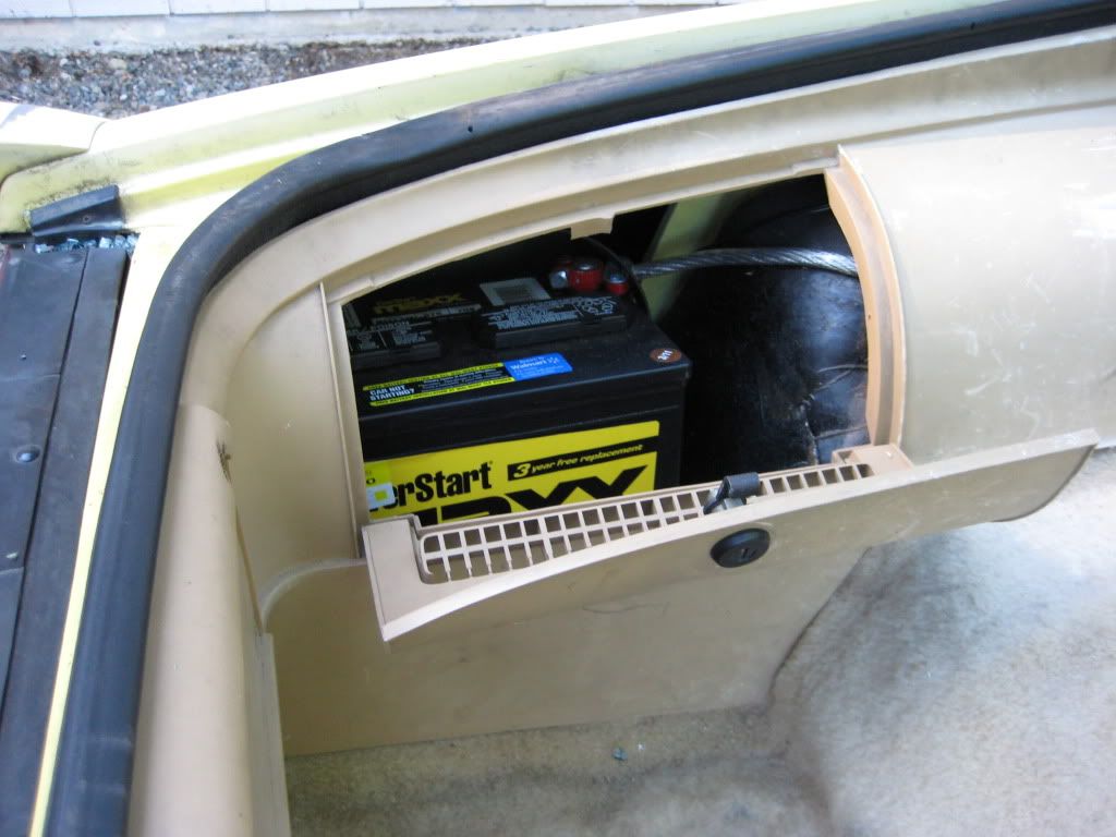

Also, if you were curious how not to do a rear-mount battery, this is it:
Idiots:

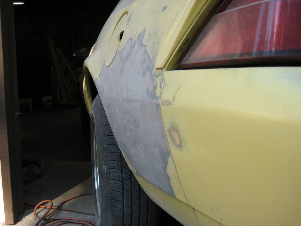

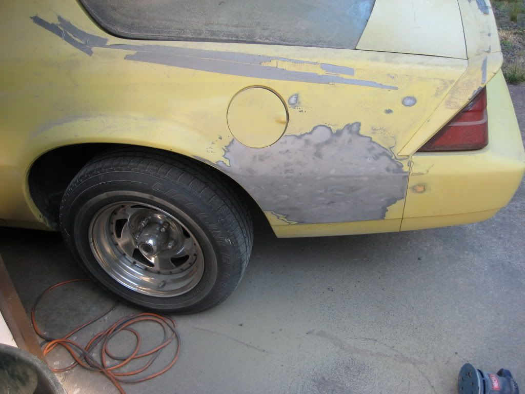

I only found one spot on the car I didn't like, but decided to buy it anyway. The first thing I did this morning was knock it down:
Their bondo went as far out as I sanded, but it's not really deflected, so I'm not sure why they feathered it out so far. I think this area could have been spot puttied and shot over (which is probably what will happen. Either way I need to go buy some more dust masks and get back to work. Very Happy

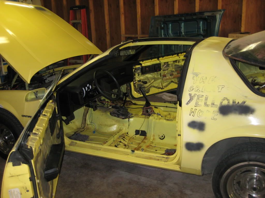

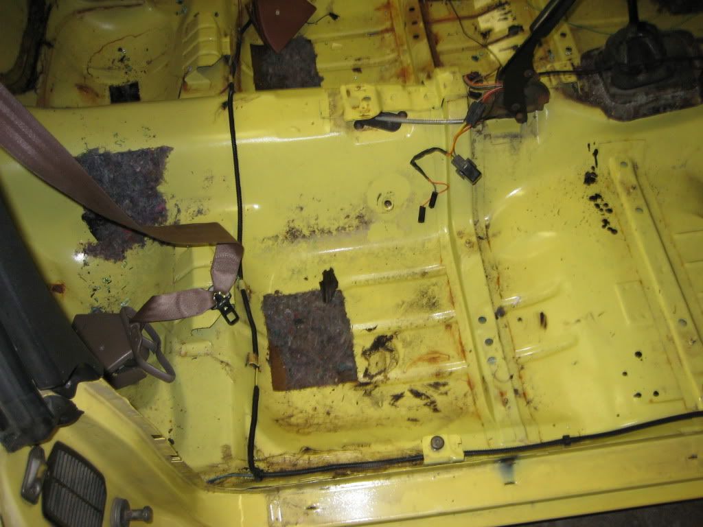

I found metal consistently all over the car, so I think the damage is only in that one spot. It will need a new passenger door and driver fender, but that's no big deal.
I sanded for awhile, but then got bored of that and decided to do something about the smell. It was sort of a cigarettes and bad cologne mixed with swamp stench aroma. So I fixed that but good:

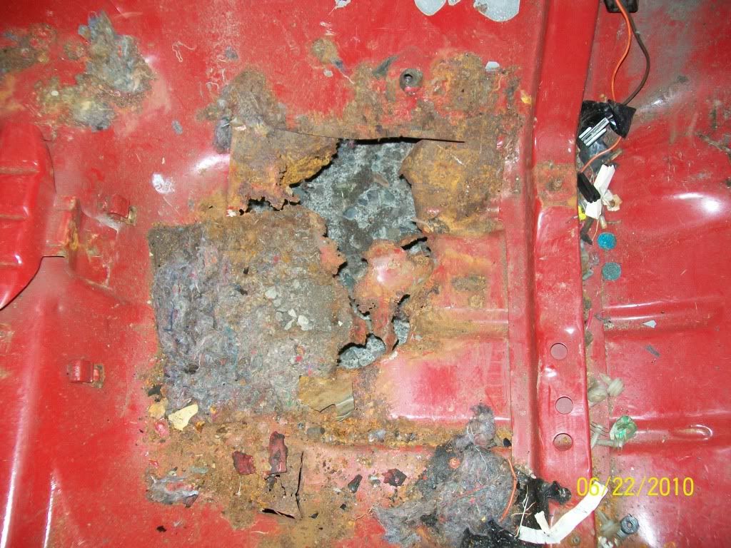

I was pretty shocked at the near-complete lack of rust in the floor, specially considering how wet the underpad was. Compare and contrast: Laughing

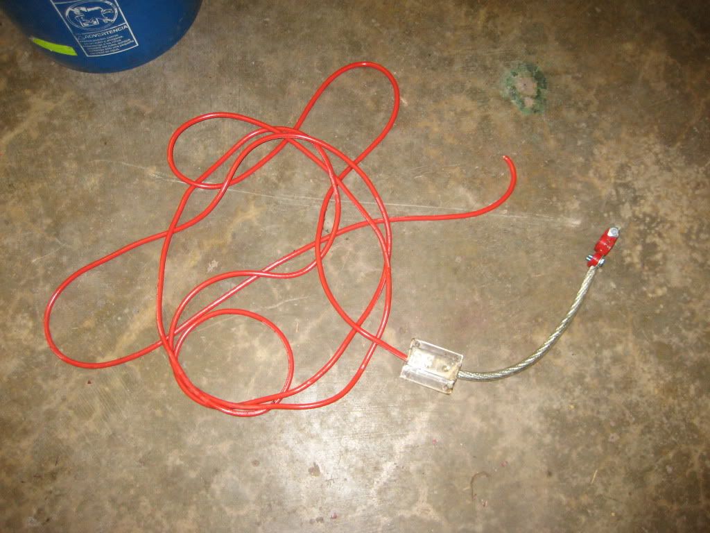

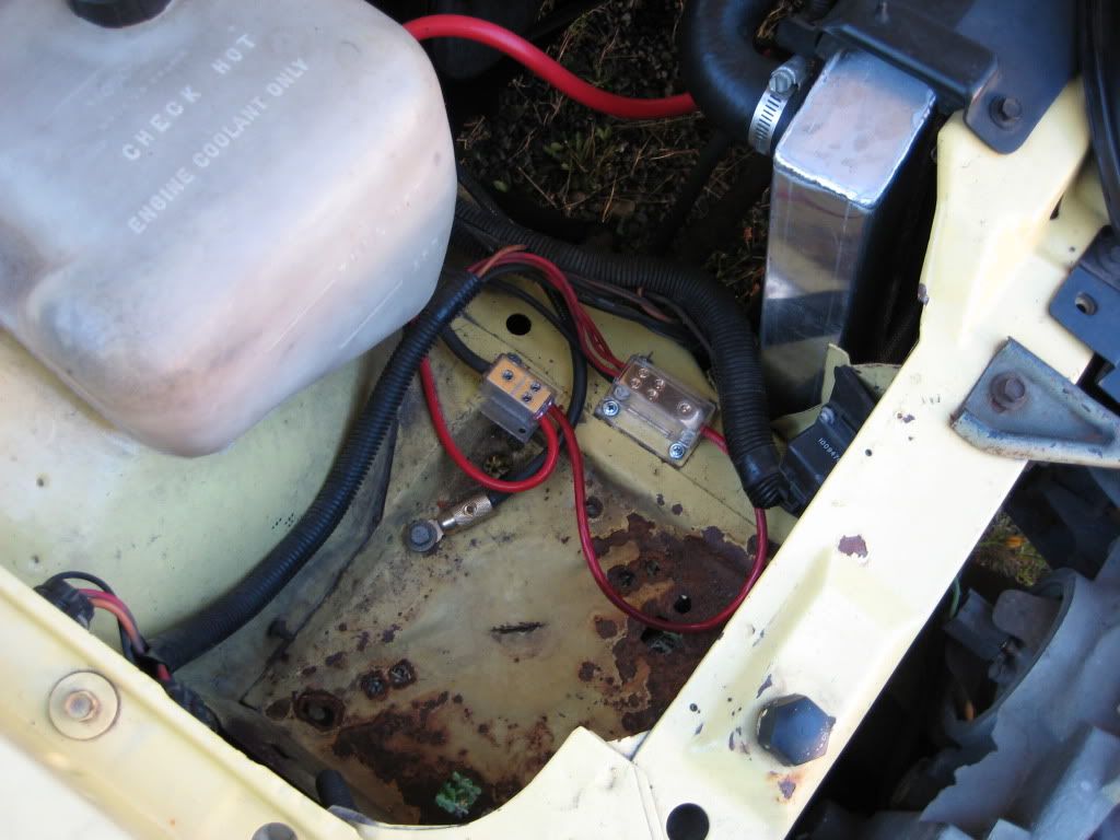

I figured the slow cranking problem I was having was due to the lame-brained rear mount battery, and I was right:
Yes, that was 8-gauge amplifier wire feeding the entire car! Shocked

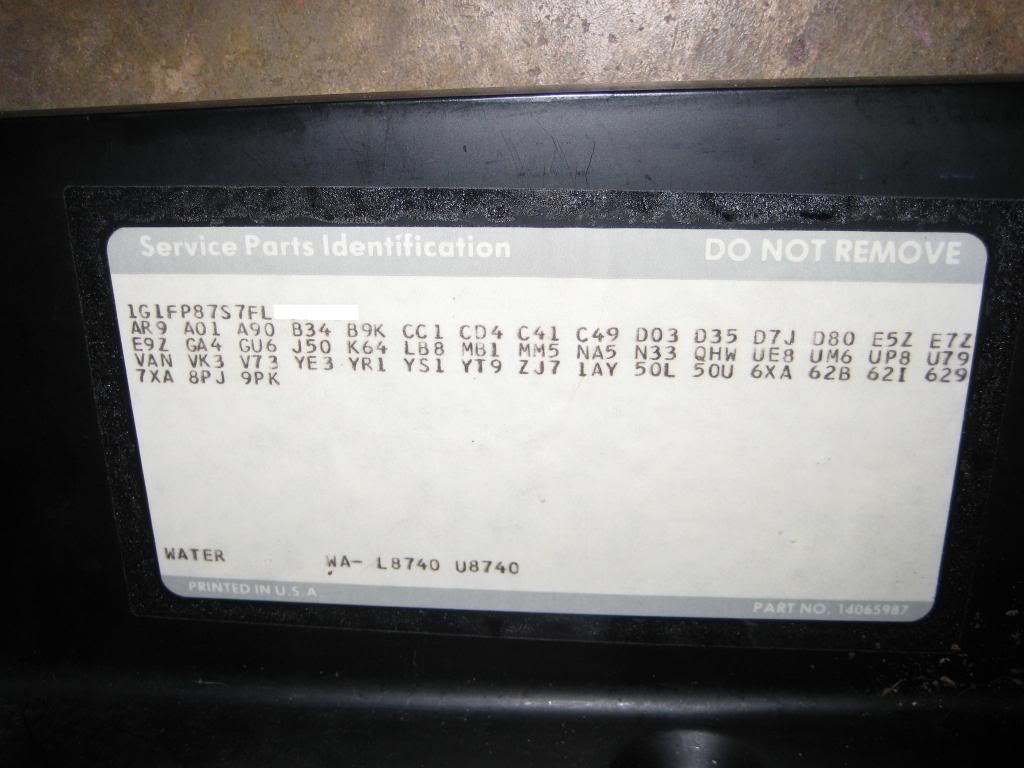

Very short RPO list:
That looks somehow familiar, though not for the same purpose Laughing
PostPosted: Sat Aug 20, 2011 7:14 pm    Post subject: Reply with quote
Haha! Al, those bean-brains could not have imagined a setup as nice as yours in their wildest dreams. Wink

3.42 gears; typical of V6 5-speed Camaro
Yes. Very basic options. Multi-speed wipers, defrost hatch, hatch popper, nicer seats, t-tops, spoiler, tape deck, that's about it. Has a delete for the cruise control listed as well. Laughing
