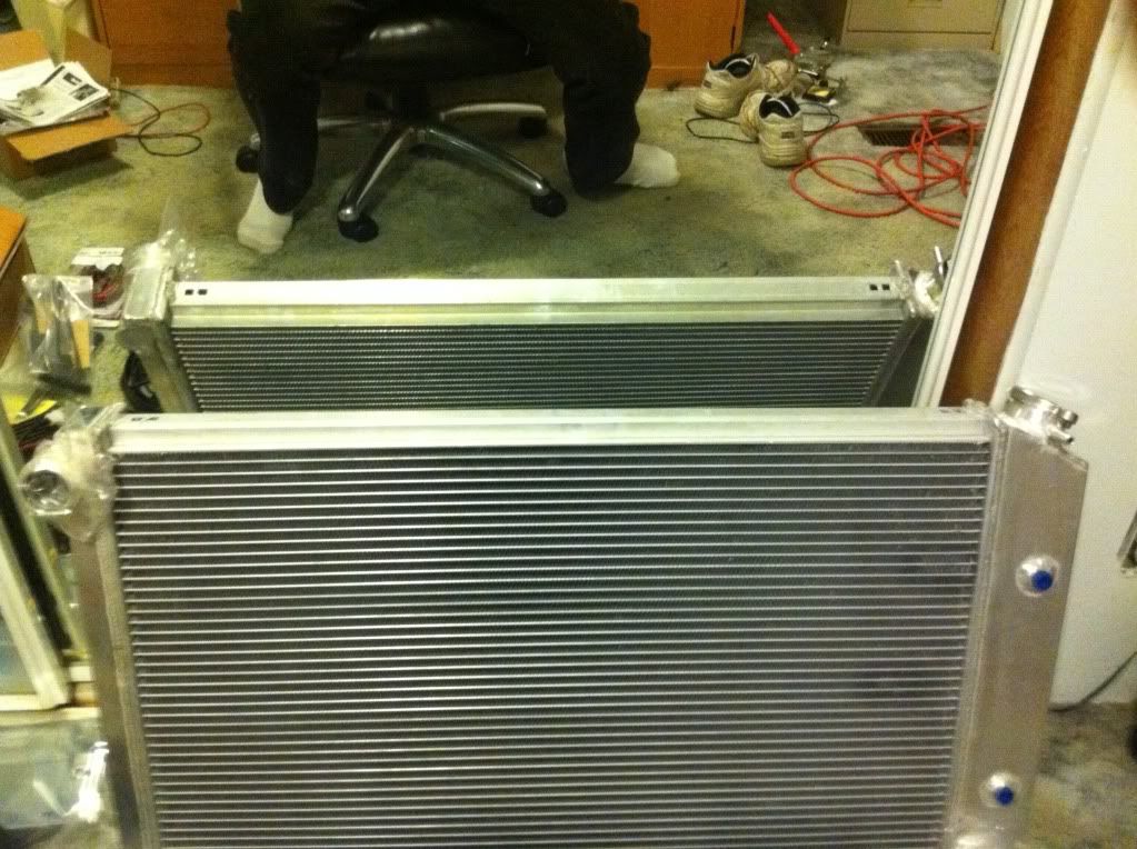

Aluminum goodness.. though I can tell Paul sure didnt weld it.. Think it must come from a chinese welding school.. brand is American Eagle. Other then the welds it appears to be a nice radiator.

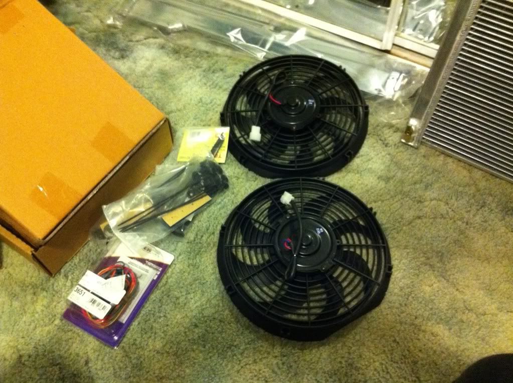

And some electrical goodies to go with it.. twin 12" fans and a hayden fan controller.

But what are you going to do with the second one?
Razz
Anything with an "American" title is made overseas.
PostPosted: Fri Aug 26, 2011 10:04 pm    Post subject: Reply with quote
Ain't that the truth!

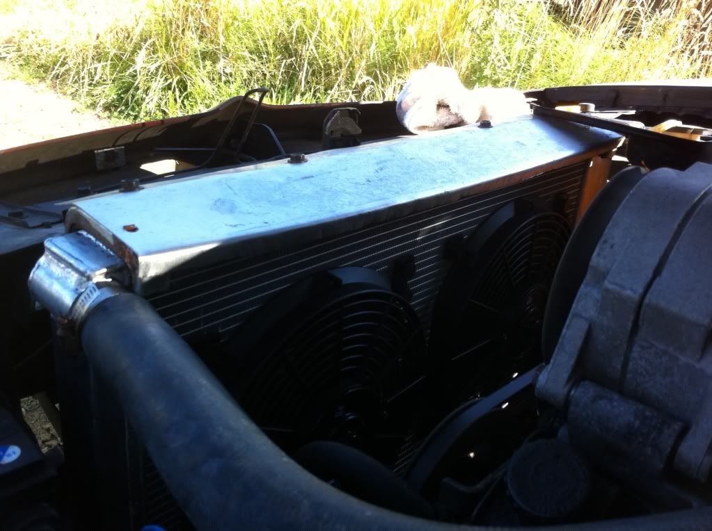

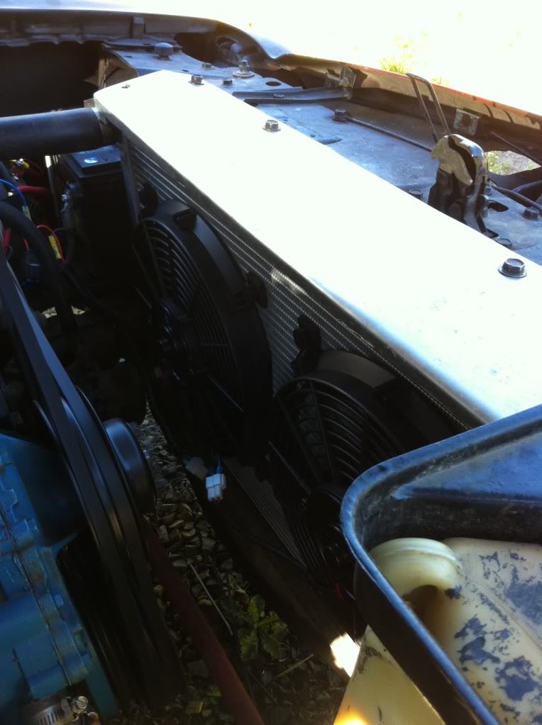

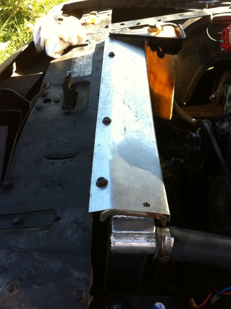

Got it all installed today. The radiator hold down was completely wrong. Wasnt wide enough even and only had 3 bolts vs 4. So I had to fabricate one out of a leftover sheet of aluminum I had and some truck parts. Very Happy Don't think I did too bad for using a hammer, vise and some pliers. Still need to polish it however. I'm still debating my choice of twin fans over a single 16. Looked like the 16 would have covered more area. These are moving lots of heat but only seem to maintain temp and not cool off.
Now for the pics.
PostPosted: Sat Aug 27, 2011 9:21 pm    Post subject: Reply with quote
Verdict in.. cruising down the road it now runs at thermo temp. Very Happy I have a 160 thermo and before it ran at about 200.
