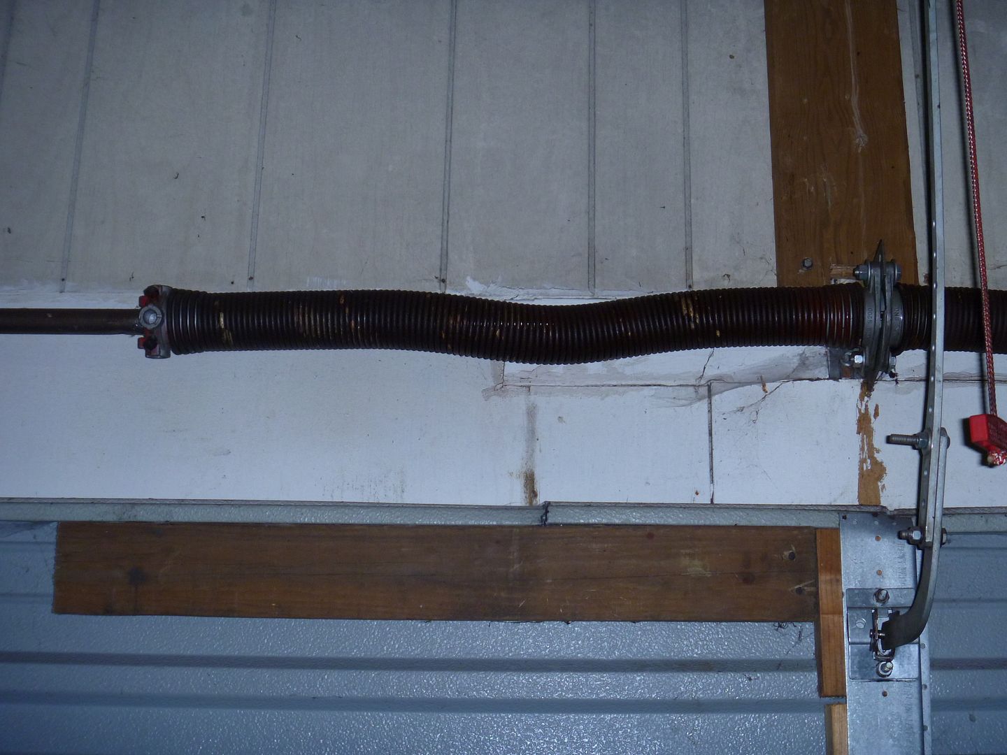

Looks like I need to replace mine. One of the torsion springs over the door snapped in half Shocked I don't know when it happened, but when I tried to open the door this afternoon, the motor would only lift it about 6" before it stopped. When I disconnected the slide from the chain, the door dropped like a rock, fortunately it was only up those 6 inches. I ordered a pair of new springs, so I'll try my hand at them in a week or two. The only experience I have with them is to wind them up shortly after purchasing the house.
My broken spring...
which should look like this...

PostPosted: Sat Jul 30, 2011 3:13 pm    Post subject: Reply with quote
Well, that was fun. Much easier than I thought it would be. The hardest part was persuading the old springs off the rod once I released the tension. Putting everything back together was pretty easy. I used a couple of 3/8" drive ratchet extensions about 12" long to tension the springs, I think I got a little too much because the door goes up soooo fast and easy now Cool
