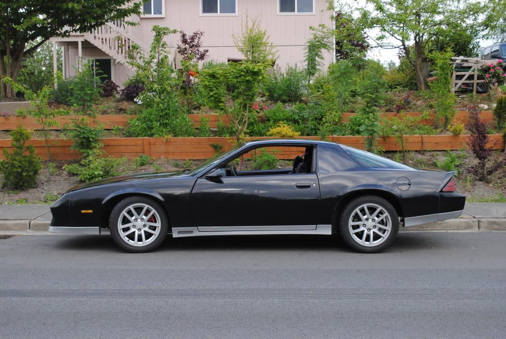

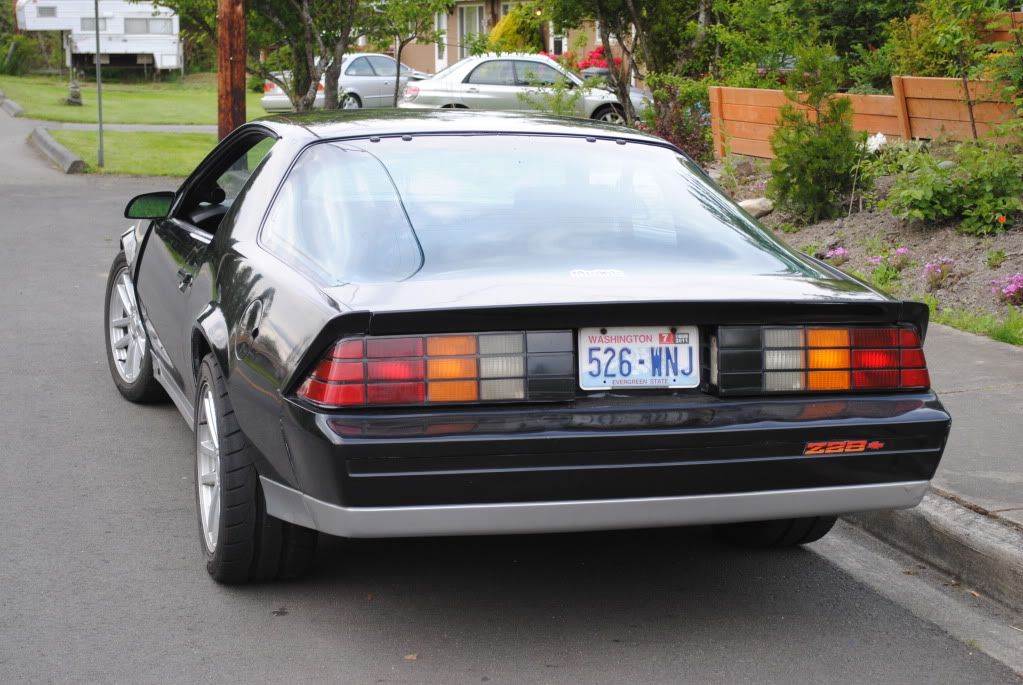

Rear needs to go maybe a bit lower...
I rub pretty hard over bumps and especially while turning over bumps. Sad
I love this first pic, it looks great. Very Happy

PostPosted: Mon May 30, 2011 5:22 pm    Post subject: Reply with quote
How much is off the back right now, Gabe?
PostPosted: Mon May 30, 2011 5:23 pm    Post subject: Reply with quote
The back is minus 1.25 coils as of right now.
Front is minus 1.5 coils I believe (maybe 1.25), I cut it once before but don't remember how much cause it was a couple years ago. Embarassed
