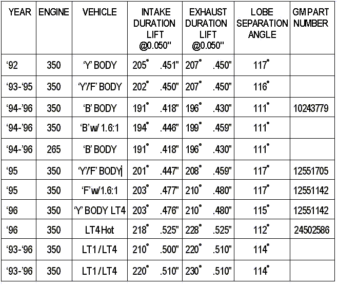

PostPosted: Tue Oct 19, 2010 10:39 pm    Post subject: Reply with quote
91camaro_rs wrote:
ok so here is whats going on and i have a few more questions
1. is a LT1 cam from a corvette different than a camaro? if so which one should i use
2. Should i use the L03 heads or the 416 heads from my LG4? (which would be better for my setup is what im asking i guess)
3. would it be worth it to buy both of the LT1 cams and sell one and keep one, he wants $10 each, im going thursday to get at least one
1.
2. No idea.
3. Yes. You may keep it on the shelf for a bit but you could make 15-30 bucks off it.
91camaro_rs
Joined: 03 Dec 2008
Posts: 1712
Location: Fox Island, Wa
PostPosted: Tue Oct 19, 2010 11:08 pm    Post subject: Reply with quote
Which one is a corvette? If I remember right he said it was out of a 97
PostPosted: Tue Oct 19, 2010 11:14 pm    Post subject: Reply with quote
'97 was LS1...
Y-body is corvette.
