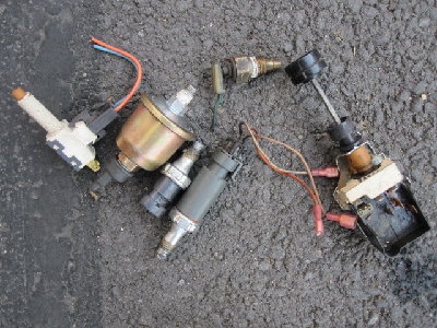

http://www.cascadecrew.org/phpBB2/viewtopic.php?t=7593&start=0
Long skinny grey one with wires coming off of it in the middle/bottom.
PostPosted: Fri Aug 20, 2010 4:05 am    Post subject: Reply with quote
FPR Fuel pump relay. Laughing Wasnt even thinking about regulator when I typed that, ops. The junkyards here rarely have these cars anymore. So by the time I pay entry fee(yes that is correct), find the part, get it off. For about 5 bux more I can go get a new one which I would rather have. I dont see how I'm looking into this to much. Just needed to know which of the 3 wires I need to hook up to?
So tan is to the dash, got it.
In twilights pic. I want to replace the 3wire gray n metal thing. With the single wire gold one. And jump the orange and gray if needed.
