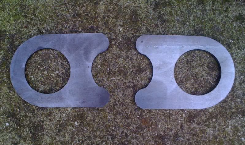

Got my bracket designed and found a guy on CL that will plasma cut them out for $25. That's a steal. I have to supply material, but I was expecting at least $75 minimum for this. If you need parts cut like this I'll post a link to him.
He has 4ft x 8ft capacity.
Now need to start looking for someone to sand blast the rear to get rid if that hideous, god awful, fugly, ugly RED that someone painted the rear with. How could anyone in their right mind ever paint car parts red like that Ewwwww

Got my caliper brackets yesterday. The guy did a great job for $25 including material. I designed them and emailed him the file. Easy as can be. He is a little ways out......Beavercreek but it's an easy drive.
Started drilling my axles for the new studs, but one of them is hard...............very damned hard. Glad I know how to sharpen drill bits.
If anyone needs front caliper brackets this guy is a good cheap alternative. Great work and fast turn around time. The bracket designs are online for most front brake conversions.
