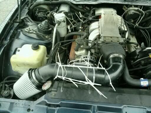

Any flaws in my design??
Those zip ties will be gone once this problem is fixed[/img]

PostPosted: Wed Feb 24, 2010 1:11 pm    Post subject: Reply with quote
Maybe make it so it's not offset at the throttle body. Reducing any turbulence is helpful. Maybe minor in this case, but helpful nonetheless.

It is like that because the rubber hose thingy is too long, any ideas on something else I could use to connect the PVC pipe to the throttle body??
PostPosted: Wed Feb 24, 2010 3:01 pm    Post subject: Reply with quote
Can't confirm, but I've heard either a 3" or 3.5" silicon coupler will oval out to the right size to clamp on to the TB. Not sure on the size, but one of those is what I remember.
So if you got for instance a 3.5" to 3" coupler (or whatever size your PVC is) it should work. Just experiment with the sizes, cause I'm not sure what sizes you'll need.

PostPosted: Wed Feb 24, 2010 5:28 pm    Post subject: Reply with quote
Holy zipties batman.
Get some couplers and clamps for that thing.
If you haven't glued up the ABS yet (it's not PVC) go back to Depot and buy a short 90*, looks like a long one in the pics. They should be able to sell you one that has the two bells almost touching each other. That will fix your length problem. Wink

Oh that would be cool ill chech it out once I find a new maf
