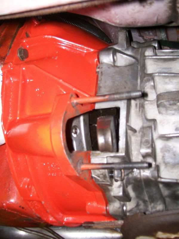

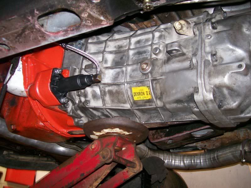

If you look at an LT1 bell housing you will see a spacer that goes on before the slave cylinder. It is part of the stock setup. The Lt1 setup is virtually a bolt in using the 4th gen hydraulics. The spacer is there because you have to slip the release fork onto the throw out bearing after you install the trans. This removable "spacer" gives you access to do this. People tend to "misplace" these when selling T56 setups and then your screwed without the spacer. I got real lucky a couple of years ago and picked up two spare spacers from GM before they were discontinued.
If you go with an LT1 style setup, you may want to consider a set of 4th gen pedals. Or like I did modify the clutch master cylinder push rod to make it adjustable. If you don't you have an abnormally high clutch release point. I have a set of 4th gen pedals I picked up that I didn't use if you go the LT1 route.
I don't totally agree with everyone about the LT1 clutch. There were millions of 4th gens produced with that clutch and they all seem to do pretty well with them. I don't have big power yet, but hopefully shortly I'll have another 100 or so more ponies and I'll see just how good the clutch is I guess. For now on the street I see no difference between the conventional push clutch and my pull type LT1 setup.
I sent you a PM on the speedo cable drive mod.
Edit: Found these pics on TGO. Shows how the spacer setup works.
