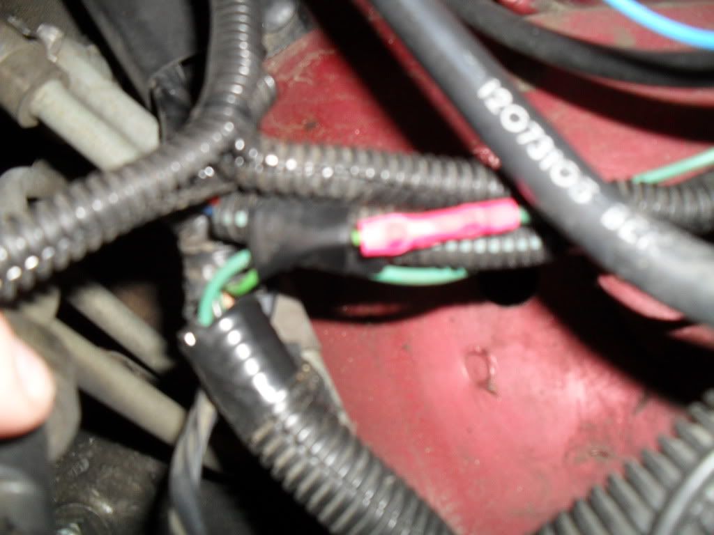

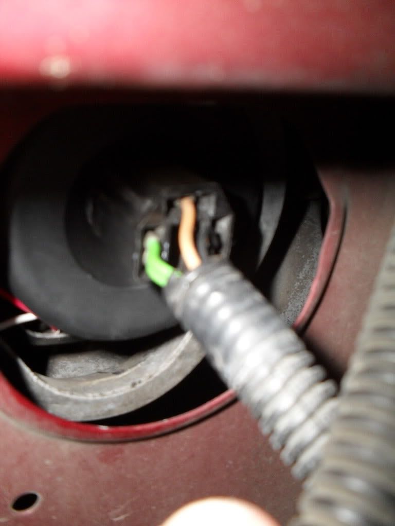

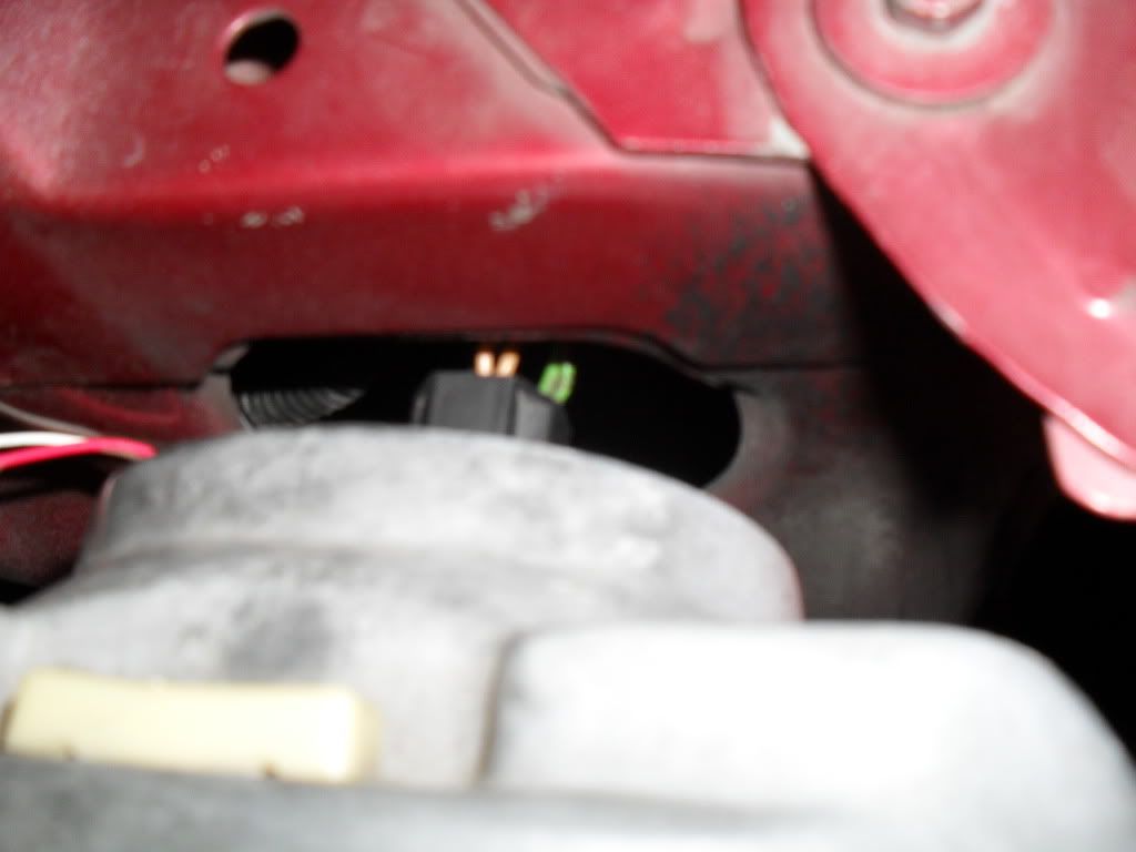

ok so my low beams look like this looking from the FRONT of the car ( high beams look the same just without the tan wire...
left= black wire
top = tan wires
right= green wires ....or just look at this pic lol
driver side low beam lookin from front of car, black wire is there but the shadow from the flash makes it look invisible
high beam:
Passenger side low beam from rear of car
the relay:
wires that i spliced that go to the relay
and this is what the high beams are doing when they are supposed to be off
hopefully this helps clear stuff up _________________

From your pictures, I think you need to switch the green and black wires. The diagram I posted shows the back of the light, not the front of the connector. Switch the green and black and you should be OK, that's how mine are wired. I repinned all 3 wires, not just the brown and green ones.
Not that it matters now, but the inner pair should have the wires switched also, then if you could jump the unused connector to the green wire, you'll be amazed at how bright your high beams are. Or just get a hi/lo headlight socket from NAPA or Auto Zone and switch the black and green wire from how they are now, then connect the green one also to the 3rd spot. |
