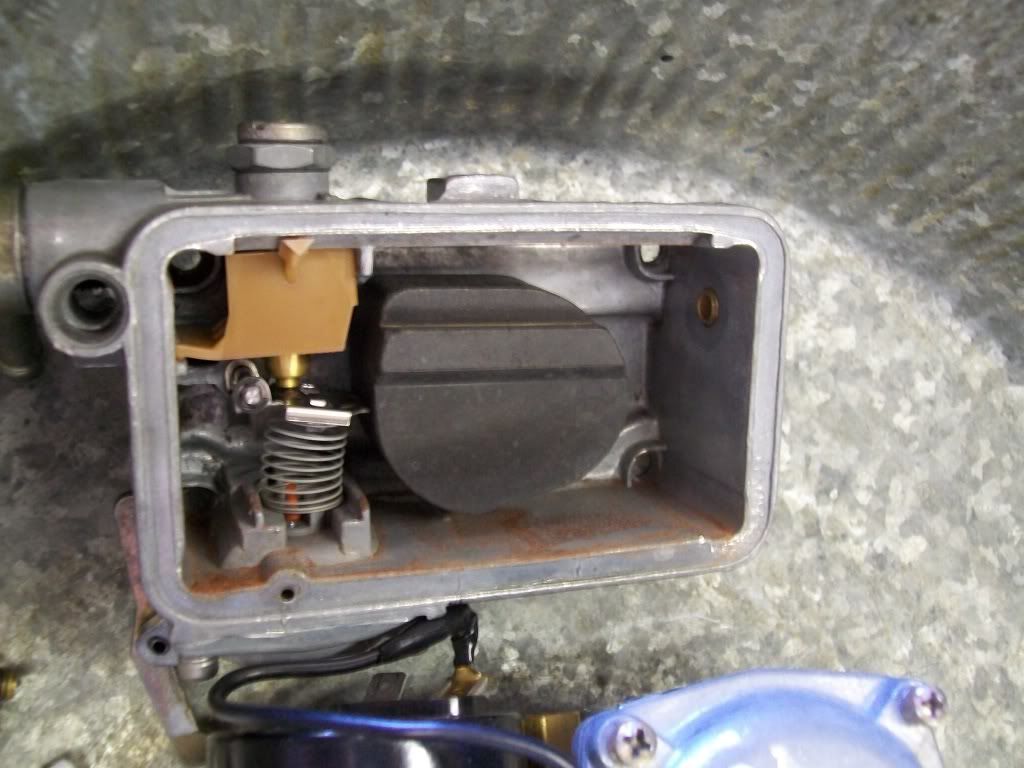

WTH is this junk in my carb?
PostPosted: Fri May 01, 2009 1:36 pm    Post subject: WTH is this junk in my carb? Reply with quote
Very fine, dense, sediment-type stuff. It's metallic and sort of red-oxidized. What throws me is that everything was cleaned out last summer: the carb was rebuilt, the tank was pulled and cleaned at a local rad shop, the pump is brand new, and I've always run it with a filter. Should I just clean it out and go, or is there something I should be checking here?

PostPosted: Fri May 01, 2009 1:42 pm    Post subject: Reply with quote
Is it in both bowls?
PostPosted: Fri May 01, 2009 1:47 pm    Post subject: Reply with quote
Haven't pull the secondary bowl yet. I only pulled the primary to up the jet sizes. It's lean-surging bad on the freeway.

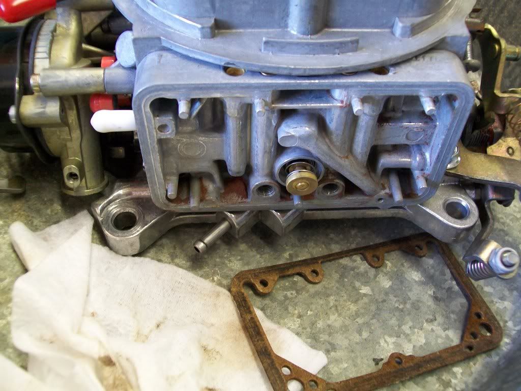

PostPosted: Fri May 01, 2009 2:15 pm    Post subject: Reply with quote
Popped the secondary off just now. There's quite a bit in it, but not as much as the primaries. Now that it's had a chance to dry out a bit, the stuff is actually pretty light, and seems to blow out pretty easily with a little compressed air.
For now I think I'll just clean it out and roll with it.

Has it been running? Did you recently rebuild it or just bolt it on and go?
'Looks pretty normal for a carb that's sat.
PostPosted: Fri May 01, 2009 10:37 pm    Post subject: Reply with quote
When I bought the car that carb was sitting in the trunk. I took it to a shop and had it rebuilt when I dropped the new engine into it last Fall. I had the tank cleaned at the same time, and replaced all the soft line. The hardline under the car was the only thing I didn't clean or replace, which might have been the problem.
It's been running on the new engine since I broke it in, so it must not have been bad enough to affect flow.
