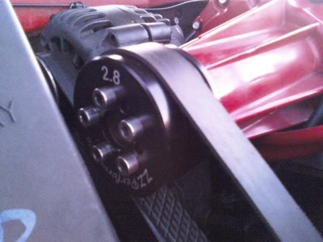

**UPDATE**
Put on the 2.8 pulley (2 sizes smaller than the previous) and it builds about 15-16 PSI and I upped the timing again to around 19.5-20.0* advance and it STILL won't knock.

PostPosted: Fri Mar 06, 2009 11:50 am    Post subject: Reply with quote
This is the smallest pulley you can run on the stock snout...you cannot even stick your fingernail in between the pulley and the snout LOL
