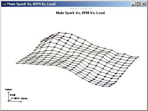

PostPosted: Wed Dec 12, 2007 9:02 pm    Post subject: Reply with quote
Here is how mine looks.
100kpa is on the far right.
PostPosted: Thu Dec 13, 2007 7:08 pm    Post subject: Reply with quote
Thats a fairly smooth spark table. Even the stock L98 one I pulled up was wavier then that.
Ran my new fuel chart tonight. Fixed the sputter I had in high 4th gear. Still got a check engine light when I got on the interstate and kept in it. I suspect its that spike at 3800@70+kpa.
Fixing to merge spark tables and check my fuel again. Very Happy
PostPosted: Thu Dec 13, 2007 7:29 pm    Post subject: Reply with quote
Stock spark tables are WACKY!!!!!!!!!!!!!!!!!!!!!!!

PostPosted: Sat Dec 15, 2007 11:11 am    Post subject: Reply with quote
For some reason that spark table still looks funky. I don't have a bin with tunerpro on this computer, maybe Paul will post the numbers or the graph from his spark table. What is the actualy ammout of advance you are running when you get the knock?
