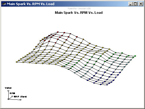

Does anyone have a TPI 5.7 that they have tuned? I have a question, why is there a dip in the spark map at 3200-3600RPM? Its visible in the AUJP.bin file.

Can you post a picture of it? You also need to check the spark adders, it could be adding spark from something else in there.
Both paul and myself have had the best luck tuning, when we got rid of all the secondary spark tables, and tuned with the main spark table and made it a nice smooth table. ramped spark up to about 32*-34* at 2500 rpm, then just held that advace from there on.

PostPosted: Thu Jun 07, 2007 9:59 am    Post subject: Reply with quote
This is a stock SA.
This is the one Mike modified for me.
Both have the little dip.
PostPosted: Thu Jun 07, 2007 10:26 am    Post subject: Reply with quote
Looks like a thermal image of a volcano ready to erupt.
PostPosted: Thu Jun 07, 2007 10:55 am    Post subject: Reply with quote
Right, but you need to look at your spark adders, it may be that your final timing advance does not have that dip.
FYI, here is how mine is, nice and smooth. But, I got rid of all the adders so the car is running only on this spark table. IMHO it makes it much easier to tune when you zero out all the secondary spark tables, and just tune with the on table. The only other thing that can modify spark on my setup, is hiway-mode.

We are running diffrent bins, but GM's code does a lot of the same stuff. You would want to look at the extended table, and temp correction vs load to see if any of them have a RPM refrence. If none of them have an RPM refrence then you just have a dip in the main spark table, I would smooth it out and get rid of the dip. But, when you are dealing with GM code, you want to double check and make sure that you don't actualy have more timing in there coming from something else.
PostPosted: Thu Jun 07, 2007 11:32 am    Post subject: Reply with quote
I don't see any. The other spark modifiers are idle and enrich. Good thing I looked, Enrich Power Spark Advance vs RPM adds up to 8* at 4800+. Other than that it doesn't modify vs load. Should be good to just modify the Spark Main table.
