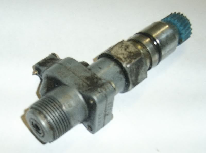

When I changed from 3.08's to 3.42's I'd just rebuilt my transmission and really didn't want to rip it apart to do a gear change. So I went to A&B and had them make me a little speedometer correction gear box. It just screws on where your cable goes, then the speedo cable screws onto the gear box. They ran my car on the rollers and then calculated what I needed for a correction. As I recall cost me about $70 installed. It was my cable that screwed things up this time, not this little gear box.

Here's a pic of the speedo correction box.

PostPosted: Tue Apr 10, 2007 7:11 am    Post subject: Reply with quote
Got it at A&B radiator and speedometer. Not sure if it works for electric speedos or not. Call and ask them.
