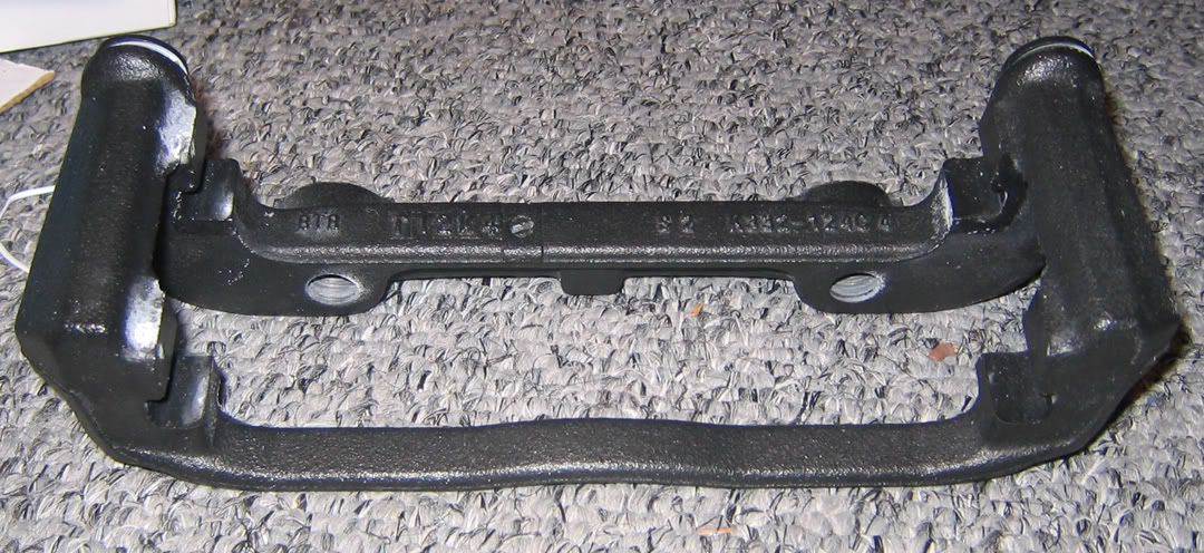

are the abutment brackets pictured here?
PostPosted: Fri May 19, 2006 10:57 pm    Post subject: Reply with quote
No, those are the brackets that adapt your spindles to the abutment brackets. The abutments are what the caliper actually sit in.
It uses a different setup than our thirdgens. A full floating caliper that is bolted to a separate bracket and then to the car.
PostPosted: Fri May 19, 2006 11:04 pm    Post subject: Reply with quote
Carrier/Abutment
Caliper sitting in abutment bracket.
Those brackets in your picture bolts to the back side of the carrier to those big ass bolt holes and then to your spindle.
