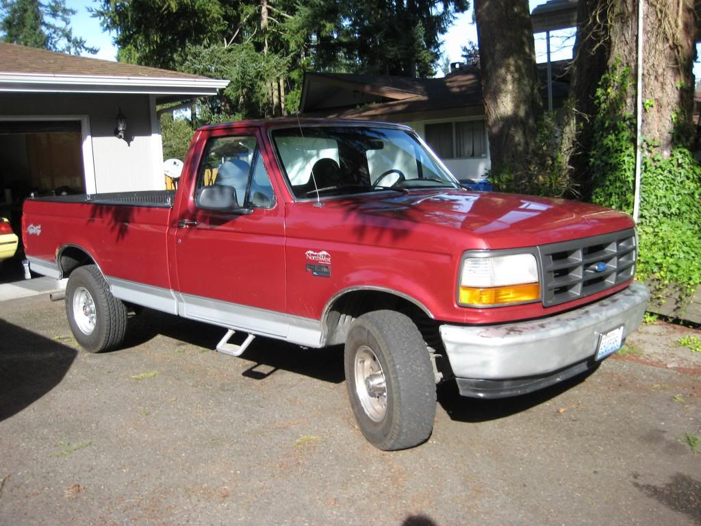

This truck has the illustrious "NorthWest Limited Edition" package, which near as I can tell consists entirely of that sticker. Squint
You kids can make all the fun you want about how picky I am when buying used junk trucks, but I got pretty nearly the exact options I wanted for a great price. This truck is truly a beer window and Rhinoliner away from being exactly what I wanted.
I'm thinking I might have to do something about those poorly-installed lady steps though. Sad

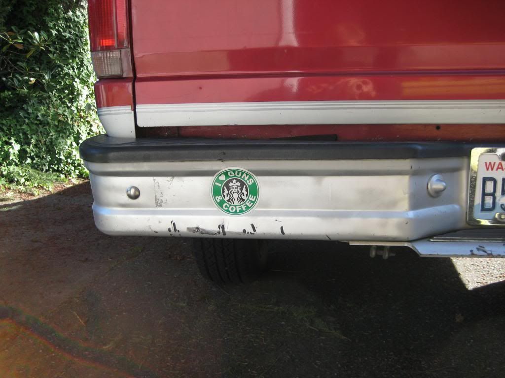

There's an easy fix for that bumper sticker. Just cut it across the center and peel off the bottom part. Laughing
PostPosted: Sat Oct 05, 2013 6:43 pm    Post subject: Reply with quote
But the sticker is inaccurate on both counts.
Guns are for people who are afraid that their penis isn't big enough and coffee is for people who are afraid that their brain isn't going fast enough.
As a man who has never had either of those problems I don't really see the appeal of either product. Cool

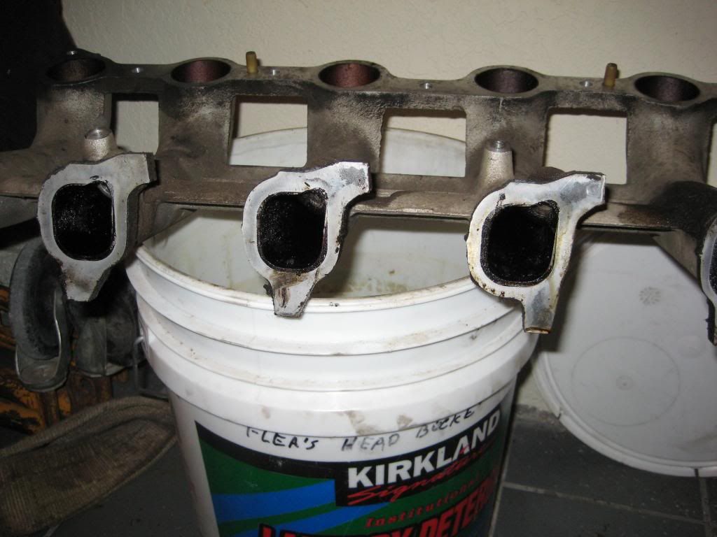

Spent today tearing the truck apart and spreading parts of it all across the garage (because of course I would do something like that!)
While I was at it I figured I would throw out this little public service announcement:
Thinking about buying some Seafoam to suck into a vacuum line to clean your intake valves? Don't.
I knew I would be pulling this one apart today, so last night I sucked 2/3 of a pint of that crap into a vacuum hose, stalled the engine and let it sit overnight. There was the usual Seafoam smokeshow this morning, but upon pulling the intake off I found all of that. Stuff doesn't do diddly squat.

1: You don't know what it looked like before.
2: It's meant to clean the hard carbon off the back of the valves and tops of the pistons.
3: I've seen it actually do that job.

All true. Without pulling the head I can't say for sure. I will tell you that I have tried it several times on several vehicles and never seen any improvement in the way they ran, which is why I wanted to do this test.

If the seafoam soaks in too much, and there is nothing but air to wash it away, you get the same.
Good gas always seemed to take care of the valves for me. As for leaking the intake? Forget it, just clean the throttle blade. Unless PVC and extended oil changes are an issue then you have to pull the damn intake.
