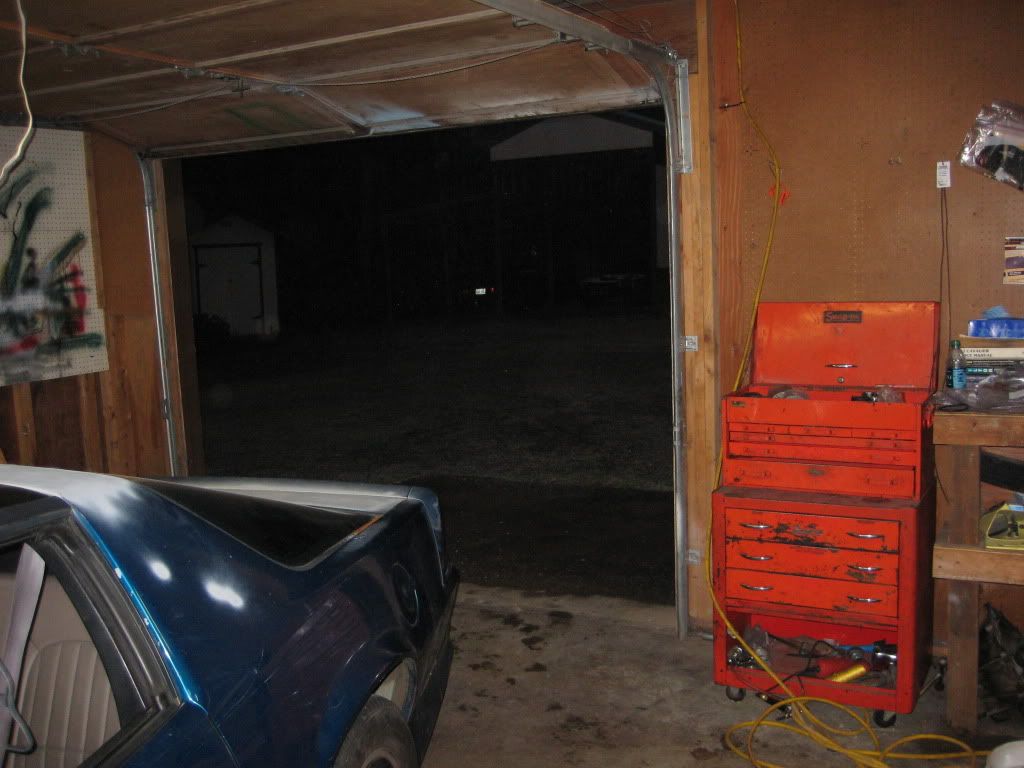

Didn't get any pictures of the pump swap seeing as I was busy working, but I did grab a pic of the snowfall starting just as we finished up:

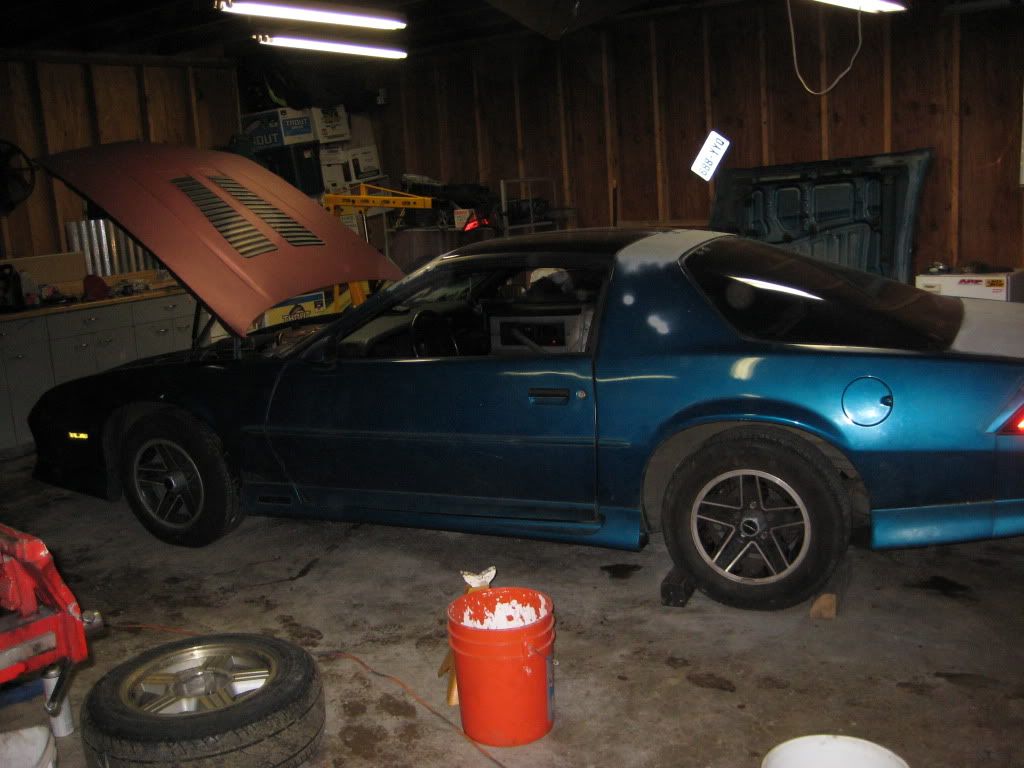

In addition to the fuel pump flea also got himself some pimpin' new rims:
Which resulted in new rims to roll bananer around on as well. Wink
The car was under cover while we were working. The snow in this shot was just what fell on it as we pushed it back into the shop.

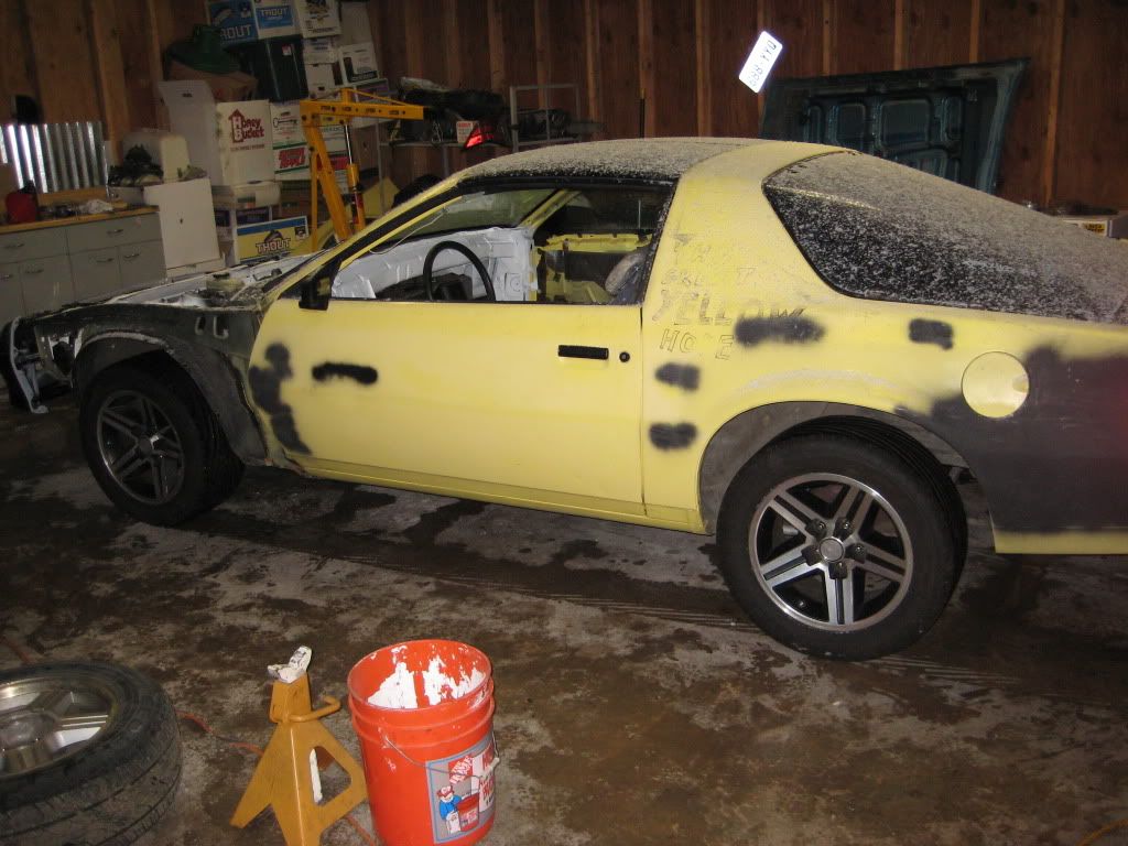

You know, the sequence of the pictures makes it look like we took my perfectly good car and stripped everything out of it and painted it yellow.

Why the rim swap? Were the tires on the bananer-mobile better than flea's? I like the 91-92 style rims better than the 15's but if it was a style choice... well to each his own. Very Happy
PostPosted: Sun Jan 15, 2012 7:39 am    Post subject: Reply with quote
Alphius wrote:
Why the rim swap?
1) The flea-mobile tires were as bald as Mike.
2) Jim liked the black and silver (which I am kinda partial to myself Very Happy)
