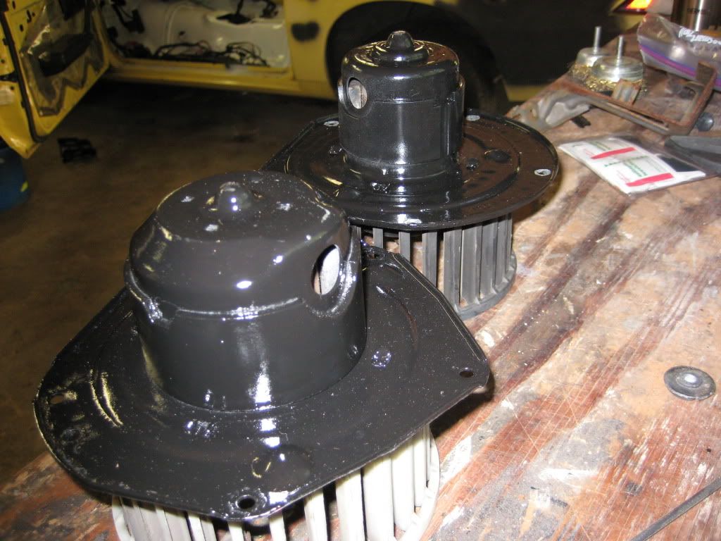

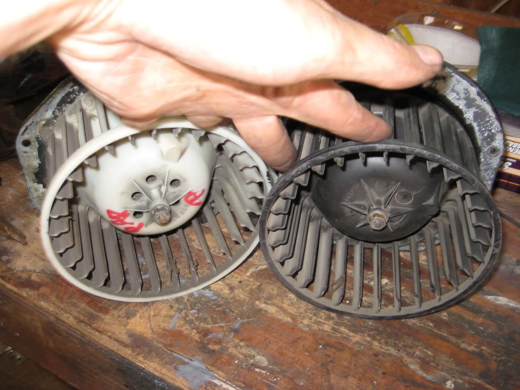

I've posted here before about GM blower motors and the different sized squirrel cages you can run in order to use an aircon motor on a delete box, and this is what I'm talking about:
The delete motor has the black cage, the aircon one has the white cage. As you can see the shaft for the aircon motor is much longer than the delete shaft. The aircon cage has very long blades, too long to fit in the delete box. You need to hit up FWD cars in the junkyard till you find a cage like the white one in the pic with short blades and the provision for the long driveshaft.

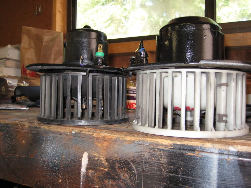

The reasoning behind this is to get a larger, and presumably heavier-duty motor. Note the size difference in the cases, which is reflected in the windings. One issue is the air inlet for the motor. In the pic below you can see the issue. This can be resolved by getting several bypass tubes from the junkyard and joining two together.

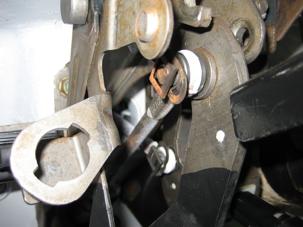

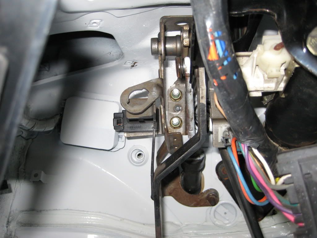

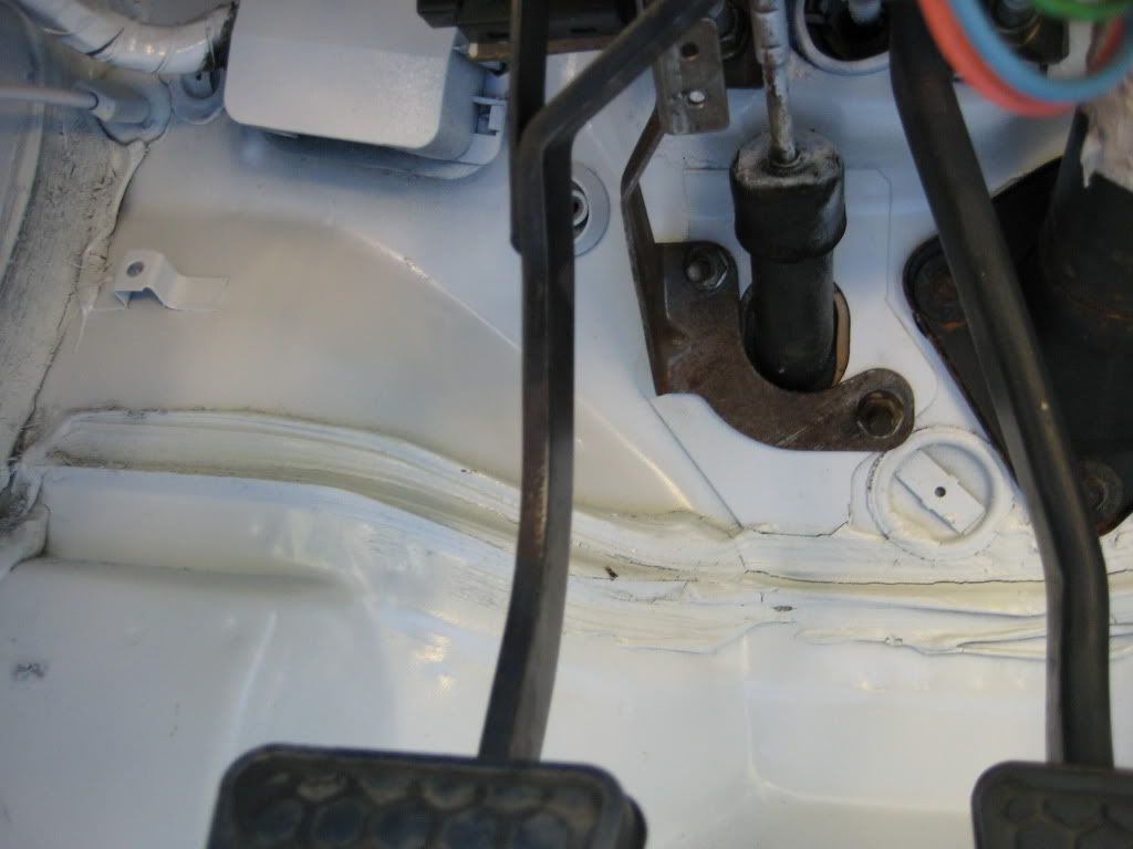

Anyone on TGO who tells you you can't mix and match third and fourthgen pedals has cousins for parents, 'cause I just did it:
All that stuff about different sized shafts on the clutch pedal and whatever is all a bunch of bull. The master cylinder is about a quarter inch diagonally down and to the left vs the thirdgen one, but I did not even need to ream out the holes, there was enough slop for it all to fit together nicely. The clutch engages a little bit lower, which I prefer to the thirdgen style. It also pushed the clutch pedal over to the driver's side an inch or more which is really nice when you wear size 11-2E workboots. Very Happy
This is how she sits as of this evening:

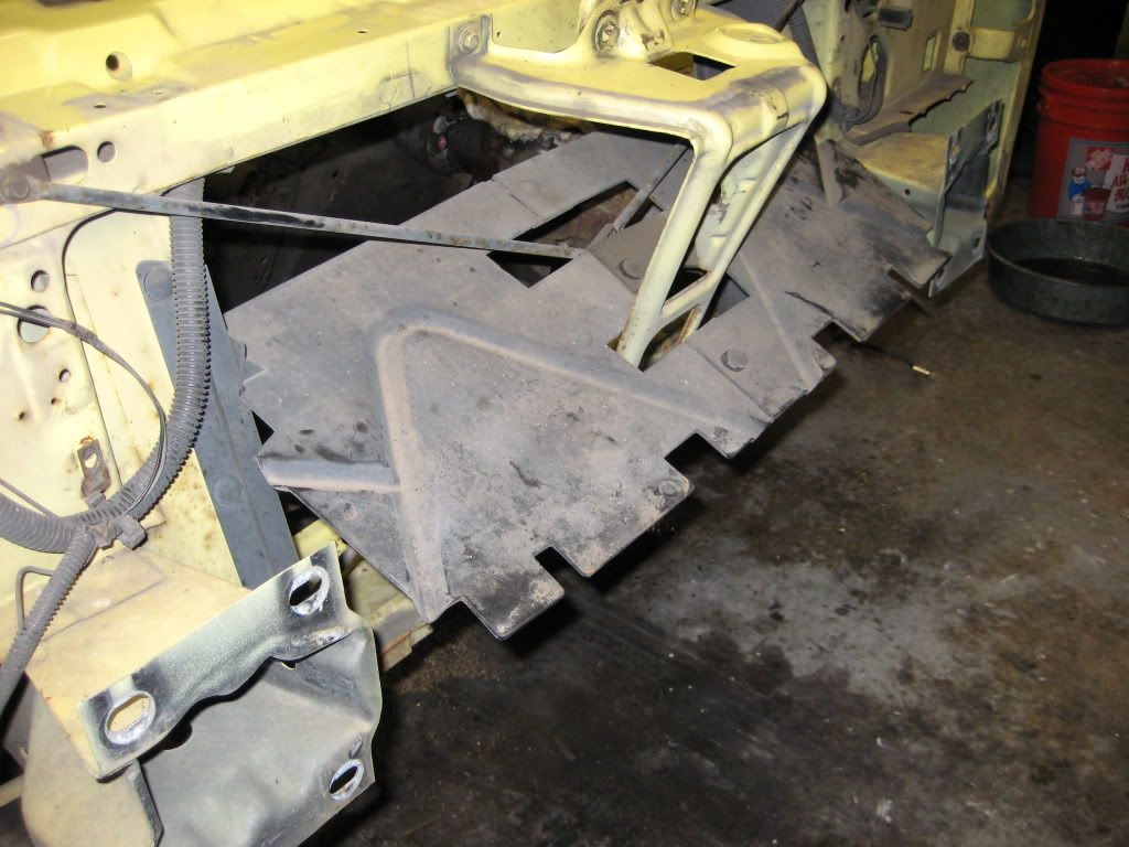

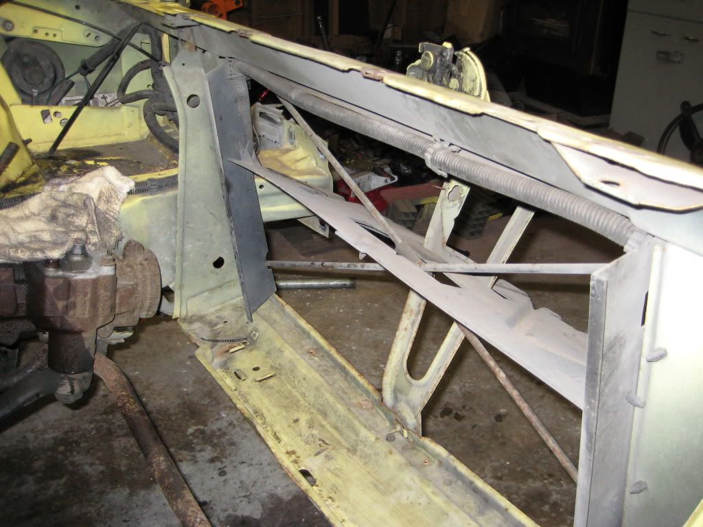

BTW, what the hell is this thing? Some sort of A/C delete baffle or something? Never seen one before:

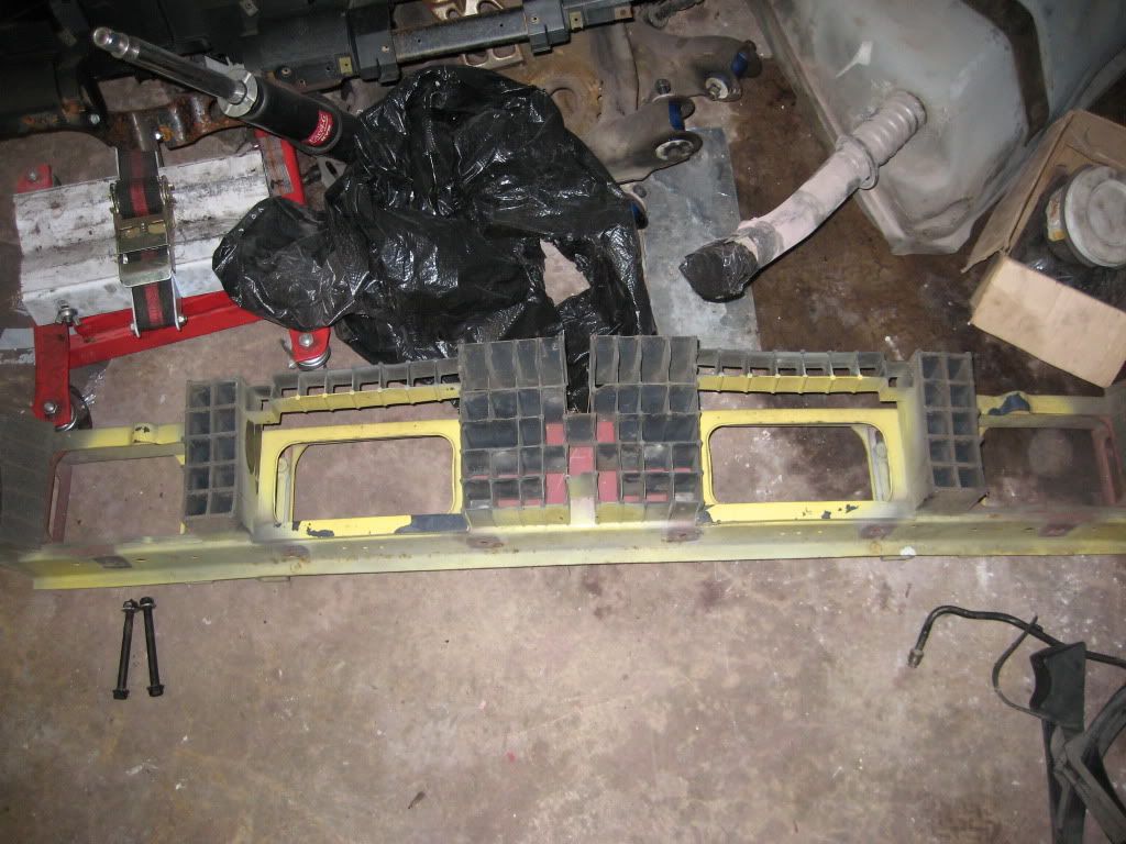

Question: Do the crash bars for the more highly-optioned cars have more meat than this one? I seem to remember the crash bar from Bondo Bucket not having the holes in it, but maybe I'm just smoking crack. (Yes, I know it's not the original bar, neither is the bumper. Horns seem straight, and everything else is original.)
Stay tuned!
PostPosted: Sat Sep 03, 2011 8:36 pm    Post subject: Reply with quote
Just part of an air box. I have the same (complete) on my 89. Most get removed for better flow, but I haven't had any issues with mine, and I'm too lazy to get up in there and remove it Laughing
PostPosted: Sat Sep 03, 2011 8:52 pm    Post subject: Reply with quote
What year was the bondomaro? The 82/83 cars had lighter different crash bars and front sheetmetal than the later cars, if i recall.
PostPosted: Sat Sep 03, 2011 8:57 pm    Post subject: Reply with quote
Both were 85's.
I think the one I have is normal and I'm just being retarded (it's been known to happen). Razz
