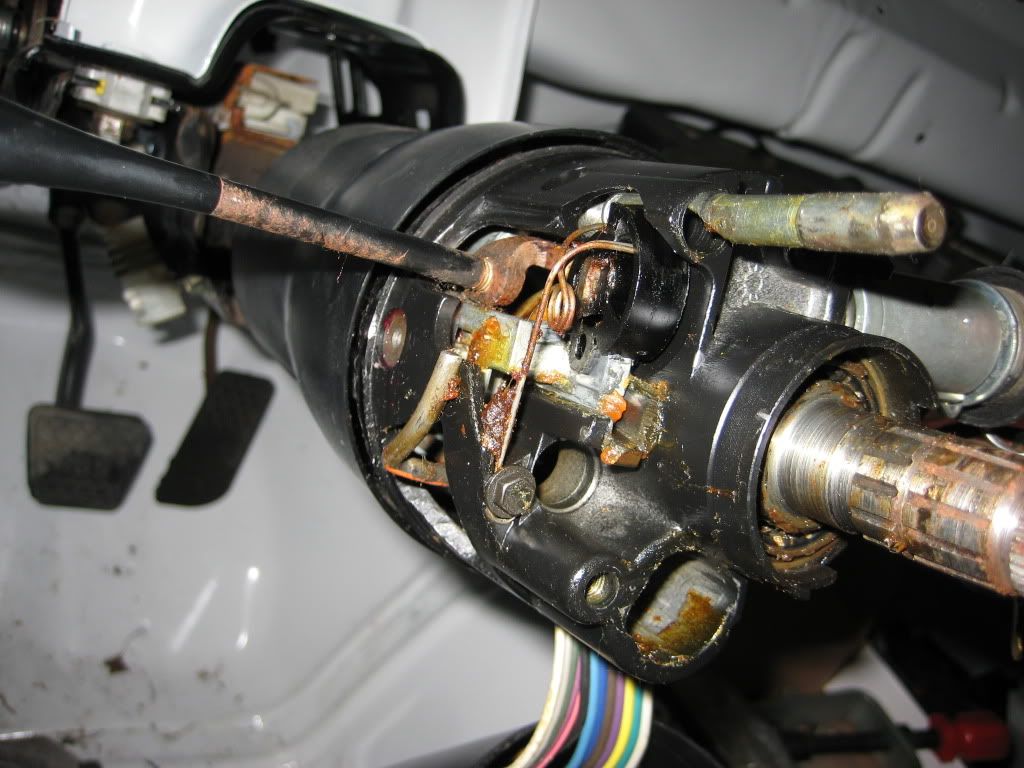

Step three: Blinkers
Now we're into the meat of this job. This is the blinker assembly:
http://i151.photobucket.com/albums/s131/aaron_sK/column/column016.jpg
See those two coiled springs? If your blinkers aren't canceling then one or both of them will be snapped off. If you have a non-tilt column and that was your only issue then congratulations, install new springs, hit page down a few times and join us later on, if not then we keep going.
You will see four black P2 screws. Three hold the switch to the column and one holds the blinker arm to the switch. You will need to move the blinker stalk to get access to all of the screws. Remove all four...
http://i151.photobucket.com/albums/s131/aaron_sK/column/column017.jpg
...then remove the hazard switch (P1 screw)
http://i151.photobucket.com/albums/s131/aaron_sK/column/column018.jpg
Pull the stalk arm down and out of the way (it may fall out, if it does just set it aside in your tray, it's no big deal).
http://i151.photobucket.com/albums/s131/aaron_sK/column/column019.jpg
Now remove whatever hush panels/ect. are under your dash and find the blinker and windshield washer harness connectors (only the blinker is shown in this pic, the windshield wiper harness is the one with the green tag in the very bottom of the picture)
http://i151.photobucket.com/albums/s131/aaron_sK/column/column020.jpg
Remove them from their various clips to the column. You may have to unplug them or you may be able to loosen enough wire under the dash. Basically you want to free up enough slack in the wire so you can push the connectors all the way up to where the wire enters the column like this:
http://i151.photobucket.com/albums/s131/aaron_sK/column/column030.jpg
This will allow you to pull the blinker switch assembly forward and out of the column like so:
http://i151.photobucket.com/albums/s131/aaron_sK/column/column022.jpg

http://i151.photobucket.com/albums/s131/aaron_sK/column/column060.jpg
Start (should spring back to run):
http://i151.photobucket.com/albums/s131/aaron_sK/column/column061.jpg
Now clean, grease and reinstall the bearing race and the cap that centers it below the spring. Do not worry if it is not perfectly seated just yet:
http://i151.photobucket.com/albums/s131/aaron_sK/column/column066.jpg
Reinstall the tilt spring using a large P2 or P3 screwdriver:
http://i151.photobucket.com/albums/s131/aaron_sK/column/column068.jpg
Step nine: Reassemble upper housing
This part can be a bit tricky. Before you start turn the ignition to RUN. Get the small plastic cover and slider that you took out earlier. Use some grease to hold the slider in the cover like this. Make sure the slider is oriented correctly:
http://i151.photobucket.com/albums/s131/aaron_sK/column/column070.jpg
I am holding it upside down in this picture for a better angle.
Now hold the plastic cover firmly against the column. It will drop into a cutout and the slider will be captured against the column and above the high-beam pushrod. Do not force it together, it has some tricky angles. If you are at the right angle it should drop in easily.
http://i151.photobucket.com/albums/s131/aaron_sK/column/column069.jpg
While holding the plastic cover against the column on the left side take the large plastic piece and set it onto the column.
http://i151.photobucket.com/albums/s131/aaron_sK/column/column071.jpg
If you have done this part right you will see that the small slider has made it through into it's hole (directly above the probe in this picture):
http://i151.photobucket.com/albums/s131/aaron_sK/column/column072.jpg
If you have the ignition in run as I mentioned earlier the lock pin should slide back making it easier to get the cover on. This is the lock pin correctly in it's hole.
http://i151.photobucket.com/albums/s131/aaron_sK/column/column073.jpg
Reinstall the three silver T-30 bolts holding the upper plastic housing to the upper column. The rounded bolt goes in the top like so:
http://i151.photobucket.com/albums/s131/aaron_sK/column/column075.jpg
http://i151.photobucket.com/albums/s131/aaron_sK/column/column076.jpg
Now would be a good time for a test of the high beam and ignition switches.
Step ten: Reassemble Ignition
It is possible that the spring holding the ignition bell trigger fell out on you (it did on me ). If so, reinstall it in the slot with the curled part of the spring down and the bent part up, like this:
http://i151.photobucket.com/albums/s131/aaron_sK/column/column085.jpg
Make sure that the upper part goes below the ignition cylinder bore like this:
http://i151.photobucket.com/albums/s131/aaron_sK/column/column086.jpg
...and doesn't stick up into the bore like this:
http://i151.photobucket.com/albums/s131/aaron_sK/column/column087.jpg
Now reinstall the lock cylinder and the cylinder hold-down bolt (T-20)
http://i151.photobucket.com/albums/s131/aaron_sK/column/column082.jpg
...and the bell trigger:
http://i151.photobucket.com/albums/s131/aaron_sK/column/column089.jpg
Step eleven: Reassemble blinker
Pull the blinker assembly up over the steering shaft with one hand...
http://i151.photobucket.com/albums/s131/aaron_sK/column/column090.jpg
...while feeding wire back down through the column with your other hand:
http://i151.photobucket.com/albums/s131/aaron_sK/column/column091.jpg
Reinstall the three black P2 screws holding the blinker to the upper column:
http://i151.photobucket.com/albums/s131/aaron_sK/column/column092.jpg
Reinstall the hazard switch (P1):
http://i151.photobucket.com/albums/s131/aaron_sK/column/column093.jpg
Fish out the blinker stalk connector:
http://i151.photobucket.com/albums/s131/aaron_sK/column/column094.jpg
...and reinstall it in it's correct position on the blinker assembly:
http://i151.photobucket.com/albums/s131/aaron_sK/column/column095.jpg
If the connector falls out don't worry about it. The other end of it is merely a peg that rides in a slot. Just slide it back into the slot and reinstall it onto the blinker switch.
Step twelve: Lock plate, wheel and big finish!
Carefully make sure the upper bearing race is seated and then install the lock plate spring:
http://i151.photobucket.com/albums/s131/aaron_sK/column/column096.jpg
Install the horn ring with the pin towards the upper left. You might have to replace the horn ring if the pin is broken off or the contact wheel on the back is burnt up.
http://i151.photobucket.com/albums/s131/aaron_sK/column/column097.jpg
Slide the lock plate down onto the steering shaft (don't worry, the splines are keyed so it will end up in the right place).
http://i151.photobucket.com/albums/s131/aaron_sK/column/column098.jpg
Slide the jesus clip down over the shaft and then install the lock plate compressor yet again:
http://i151.photobucket.com/albums/s131/aaron_sK/column/column099.jpg
http://i151.photobucket.com/albums/s131/aaron_sK/column/column101.jpg
Compress the lock plate until it is past the groove the jesus clip drops into:
http://i151.photobucket.com/albums/s131/aaron_sK/column/column103.jpg
...then shove the clip down into the groove with probes:
http://i151.photobucket.com/albums/s131/aaron_sK/column/column104.jpg
If your lock plate dust cover survived install it now.
Install the horn spring:
http://i151.photobucket.com/albums/s131/aaron_sK/column/column105.jpg
...and install the steering wheel. I believe it also has keyed splines. If not, line up the keyed marks on the wheel with those on the shaft:
http://i151.photobucket.com/albums/s131/aaron_sK/column/column106.jpg
Reinstall the safety snap ring:
http://i151.photobucket.com/albums/s131/aaron_sK/column/column108.jpg
...and snap the horn cover back on:
http://i151.photobucket.com/albums/s131/aaron_sK/column/column109.jpg
Now you can take it for a test drive and return your rented tools.
